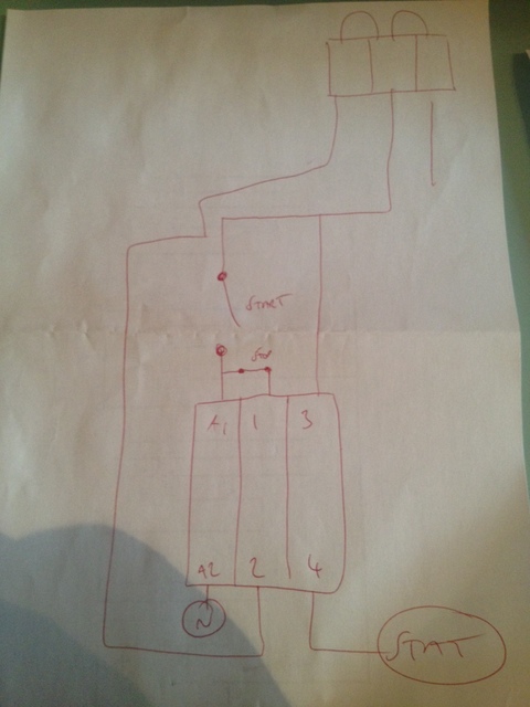

Hello,
I am new to the forum and would be most grateful if anyone here could help me with a project I am working on.
I have a control panel which I have made that controls 2 x heaters and 1 x pump.
Both heaters are 6kW (three phase) and the pump is single phase.
It all works, and I have on/off push buttons to operate the heaters and pump all run via the emergency stop button.
Where I am stuck is that my three phase heaters have a built in thermostat, which switches the contactor from on to off when the heat exceeds x degrees. My problem is that with my current design, unless someone presses the start button again it wont switch back on!
Under my current design, the thermostat isn't installed I left this until last (I underestimated how easy it would be).
Currently, all that happens is the device will turn on and off.
What I want is for the thermostat to cut in and cut off the power to the heater when temperature gets too high.
In my head I am thinking the best idea would be to have a contactor which is controlled via the on/off buttons, and that powers another contactor that is controlled by the thermostat?... or am I missing something that could help me?
I below attach the wiring diagram for both the heater in question and the control circuit diagram.
Any help would be gratefuly rec'd.

Spark what you say is exactly what I want.
What I did on the paper above is what I think your drawing is telling me to do.
My drawing will be replicated for the 2nd heater as per your post, except for emergency stop which kills all three (2 pumps and heater)
What I'm asking is what's wrong with how I've drawn it out?
All of the contactor/relay contacts on my drawing are normally open (N/O)

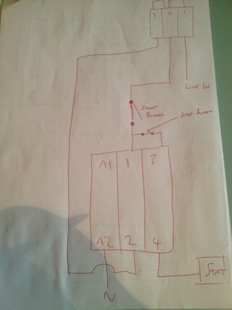

Hi Spark,
Yeah my contactors are all NO. I have removed the auxillary but Tony said in his previous post that the stat will kill the power to the controlling contactor. That is what has confused me.
Iam not sure if Tony was referring to your drawing (I suspect he was), as with mine the start/stop relay will remain closed (unless the stop or E-Stop is activated) regardless of the stat status.
On my drawing K1 is the control element to K2, K2 is the stat controlled switch which actully turns the heater on and off when the stat dictates.
Does this help any ?
I have drawn the box around K1 contacts, and the coil for K1 is shown seperate, as is K2 coil, I have added the A1 and A2 labels too.

Sorry to jump in here, but I think Spark68 has the easiest solution with your control setup, I am not sure on your diagrams how you have set this up.
Each heater has a latching contactor control by momentary start stop buttons.
This controls another contactor, through the stat control to operate each heater.
The pump control is a straightforward single latching contactor.
I think that this diagram is a simple layout (from a simple person) of what Spark68 has said.

Excellent- The only thing I do not have is a panel start and panel stop. Just an Isolator switch, then the e/stop finally start and stop buttons for each control.
Here try following this chopped down version as it in standard wiring format and youll need to learn to read them
Hi Darkwood,
Richard Burns has given me a broken down drawing with contactors and if possible I want to stick with them. I really do appreciate all your help. If any of you are interested in making these for me in future I am open to quotes. This has taken up already too much of my time and think in future ill leave it to the professionals.
Your panel start / stop is the isolator.
I have modified the diagram to show a single switch (which is the isolator).
It would help you to be able to understand the proper wiring diagrams so do not discount Tony, darkwood and Spark68 contributions, these are the ones that will make the difference and be of most use in the future. Do try and read and understand them, even if only for future reference.
