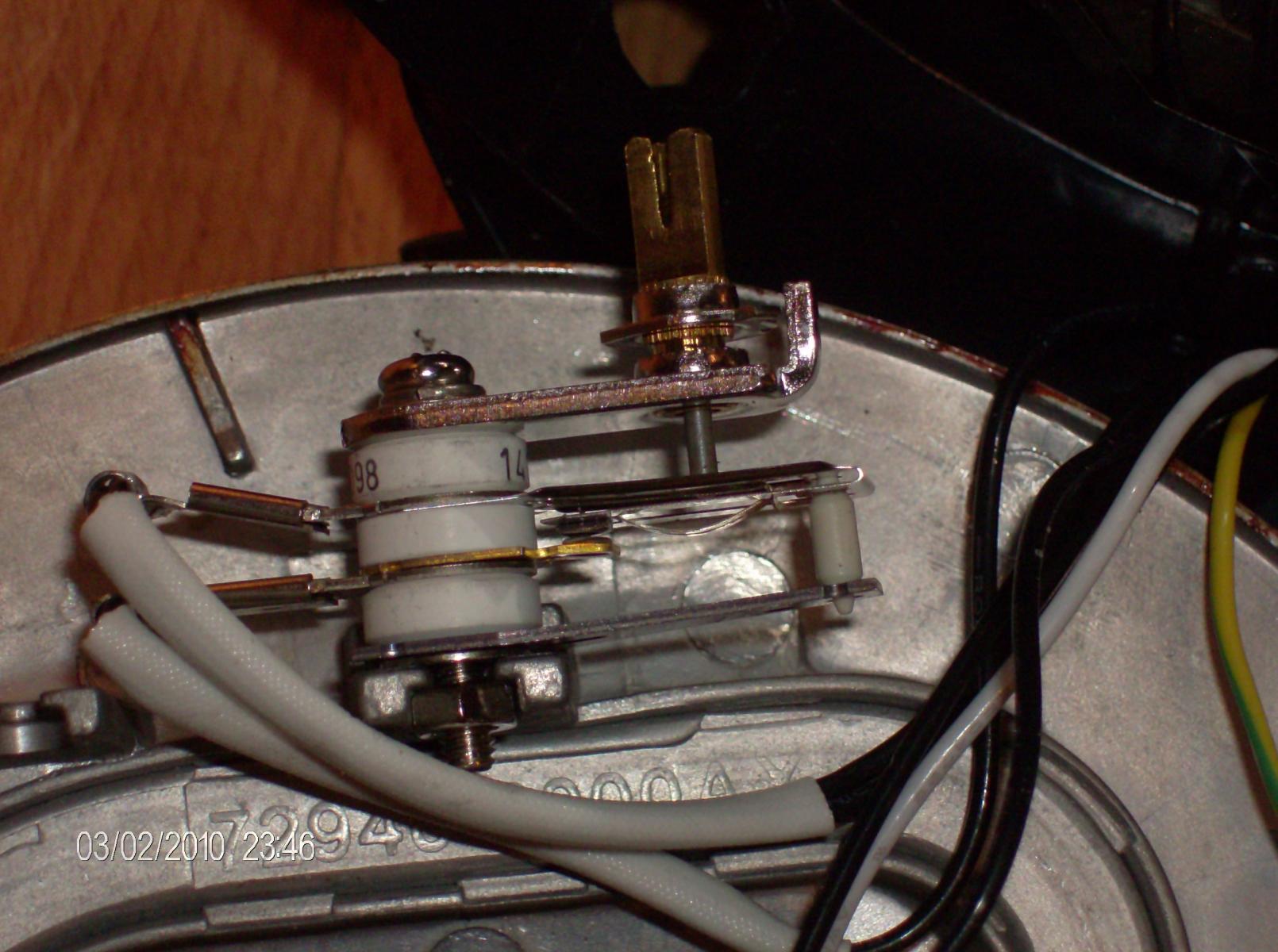

As expected, after frequent use on 220V, the waffle iron finally failed. I've isolated the failure down to a single part in the machine. I think it is a bimetal thermostat, but I'm not sure. I have posted up some pictures of the part. The first three pictures are of what I suspect is the broken part (tested it, no current running through it)
The final picture is that of what I am pretty sure is an adjustable bimetal thermostat (it can be adjusted with the setting dial).
My question is also: how do I fix this? Could I perhaps simply by-pass it and rely on the adjustable thermostat?
Thanks for your help.
3kva site tranny 230/110v is the cheapest option. also, as the max. voltage wrt earth is 55v, safety is sorted. could waffle on for hours, but IMO< that's the easiest solution.
