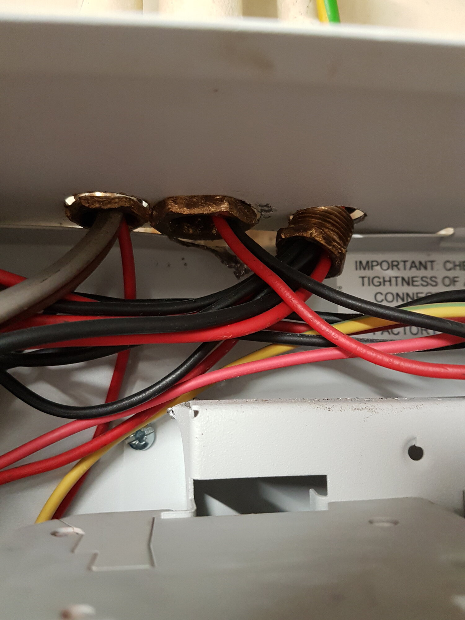

Went to a job today for random RCD tripping, removed the cover of the consumer unit and was a little surprised to see the far left neutral bar had no "true" neutral feeding it
Was not a great install and glad i did not have to carry out a EICR.
Extended the neutrals over the the correct neutral bar, replaced the 2 broken sockets (which had water damage) and told the owner that the install needs a EICR doing (Fat chance has i feel he did the board change!!!!)
