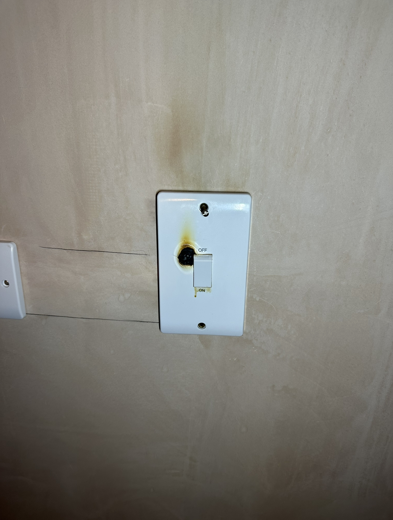

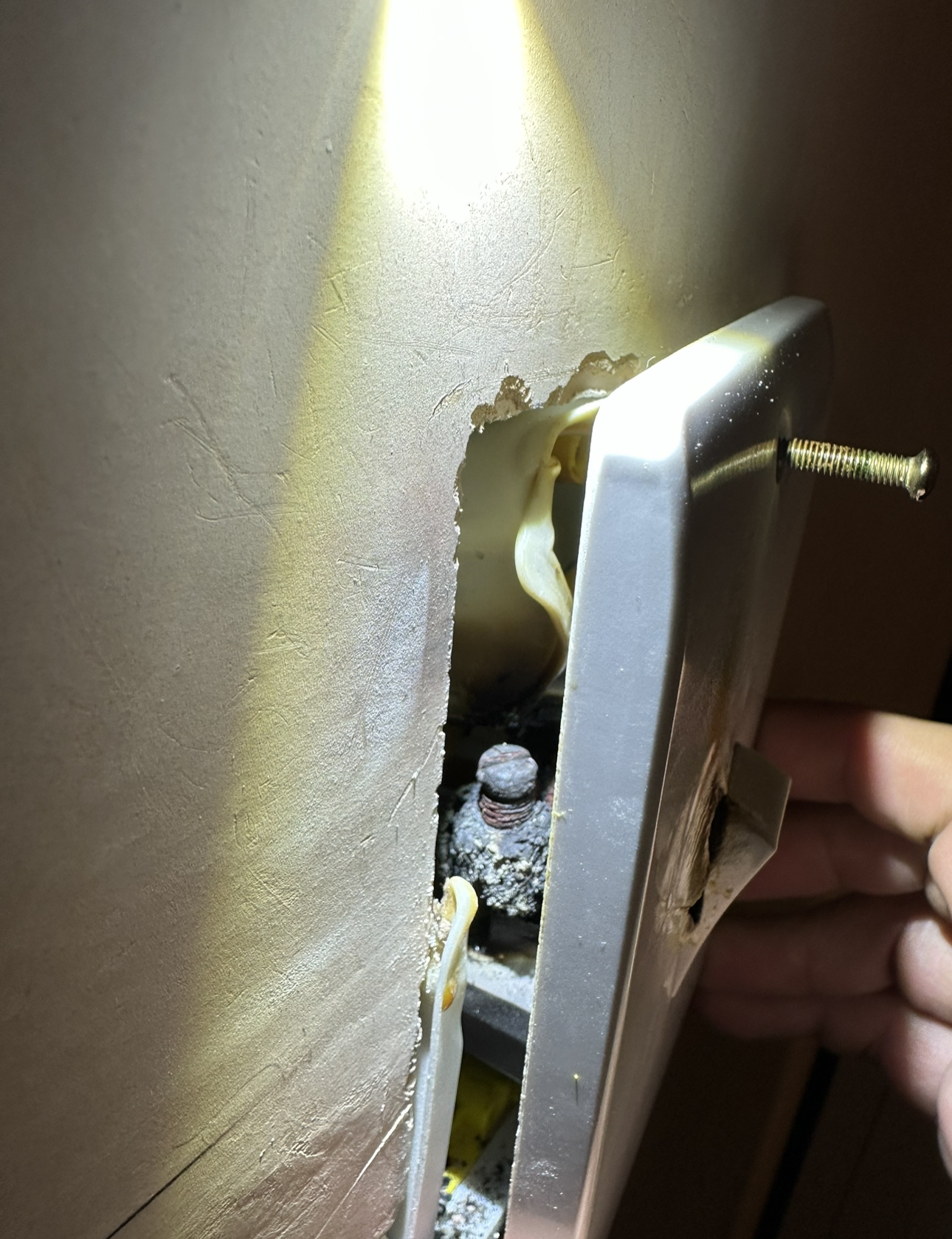

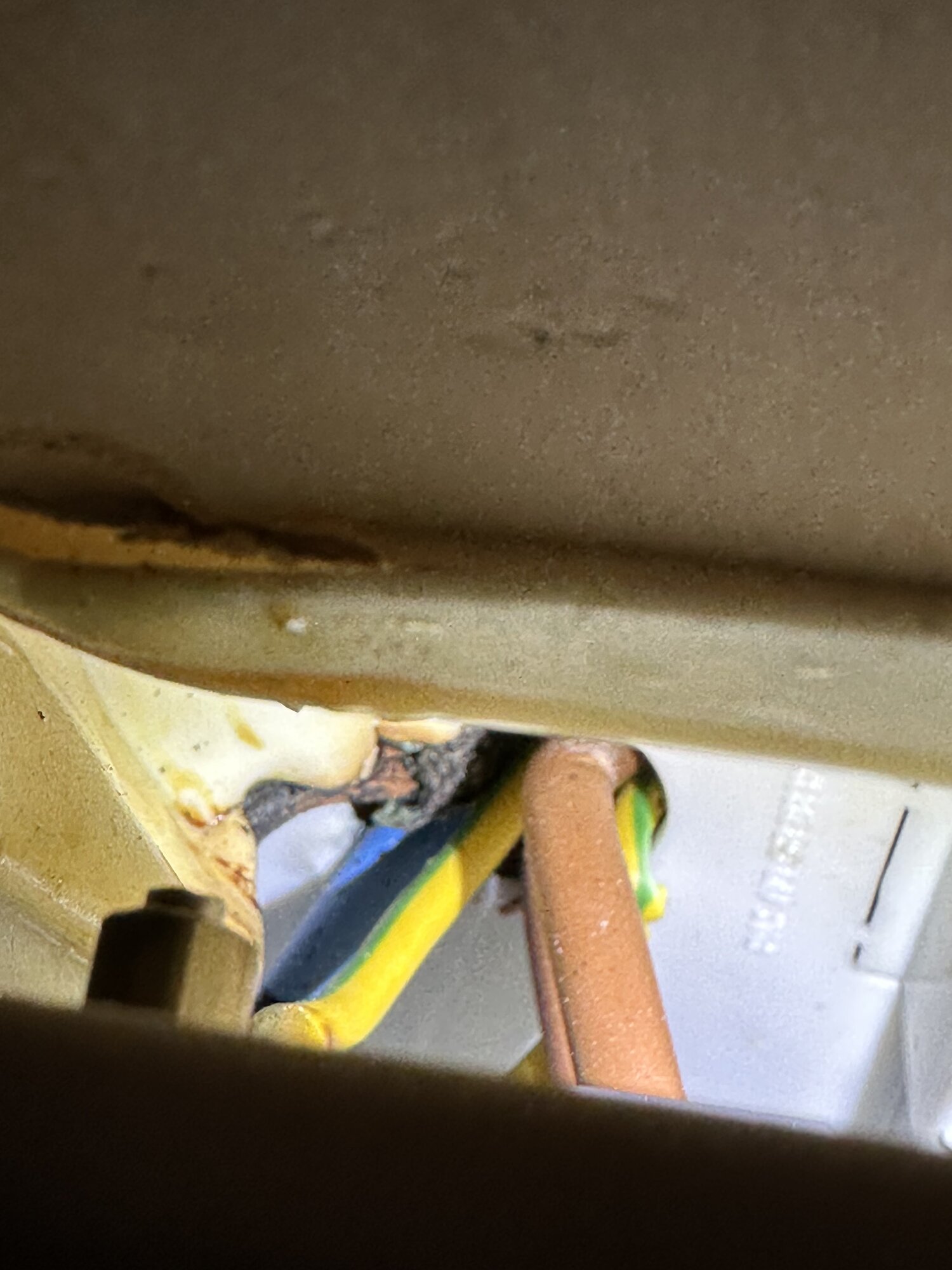

Doing an EICR today, No R1+R2 or Zs at the shower. Thought id pull the cord down to have a look. The switch just fell down, as you can see the earth and one of the live terminations has never been screwed and the other connections were not worth it.
To top it off this shower had no earth continuity to it, no 30mA RCD protection, and there was a DIY TNS reading of 532Ohms.
