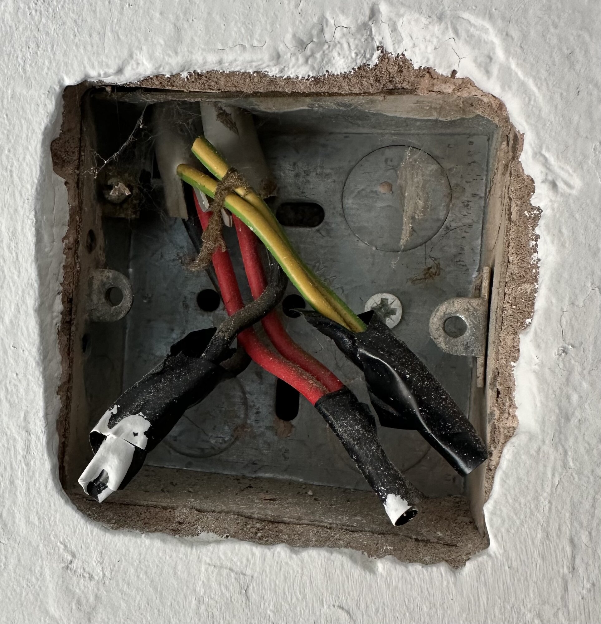

Saw a load of old conduit wiring and thought oh no rubber. It turned out to be fabric covered plastic insulation. The telephone cables hacked into the box and the earth tapped off of the lid screw were less positive. Insulation and earth loop readings were excellent throughout the installation.

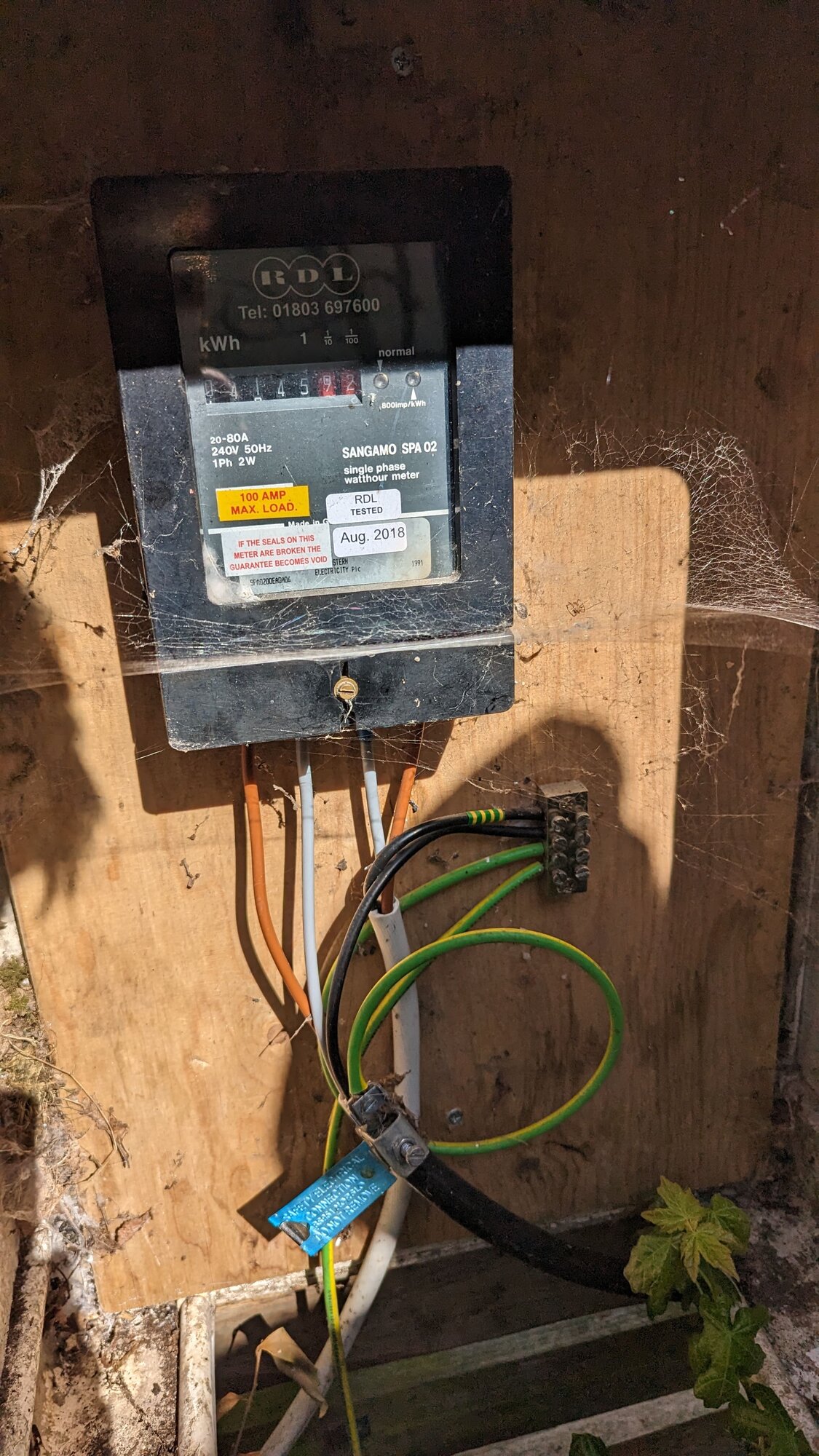

Do you reckon someone's done that as a DIY meter move? Can see the gas board doing that.
Nope.
When I left today at about 3 o'clock, I told the householder to call British Gas and report it. It was changed a couple of years ago.
Got a call at 5.00.....they were on site changing it. What a response!
Only problem now is a L-E short on the shower circuit. That lot's low down in a kitchen corner unit :rolleyes:

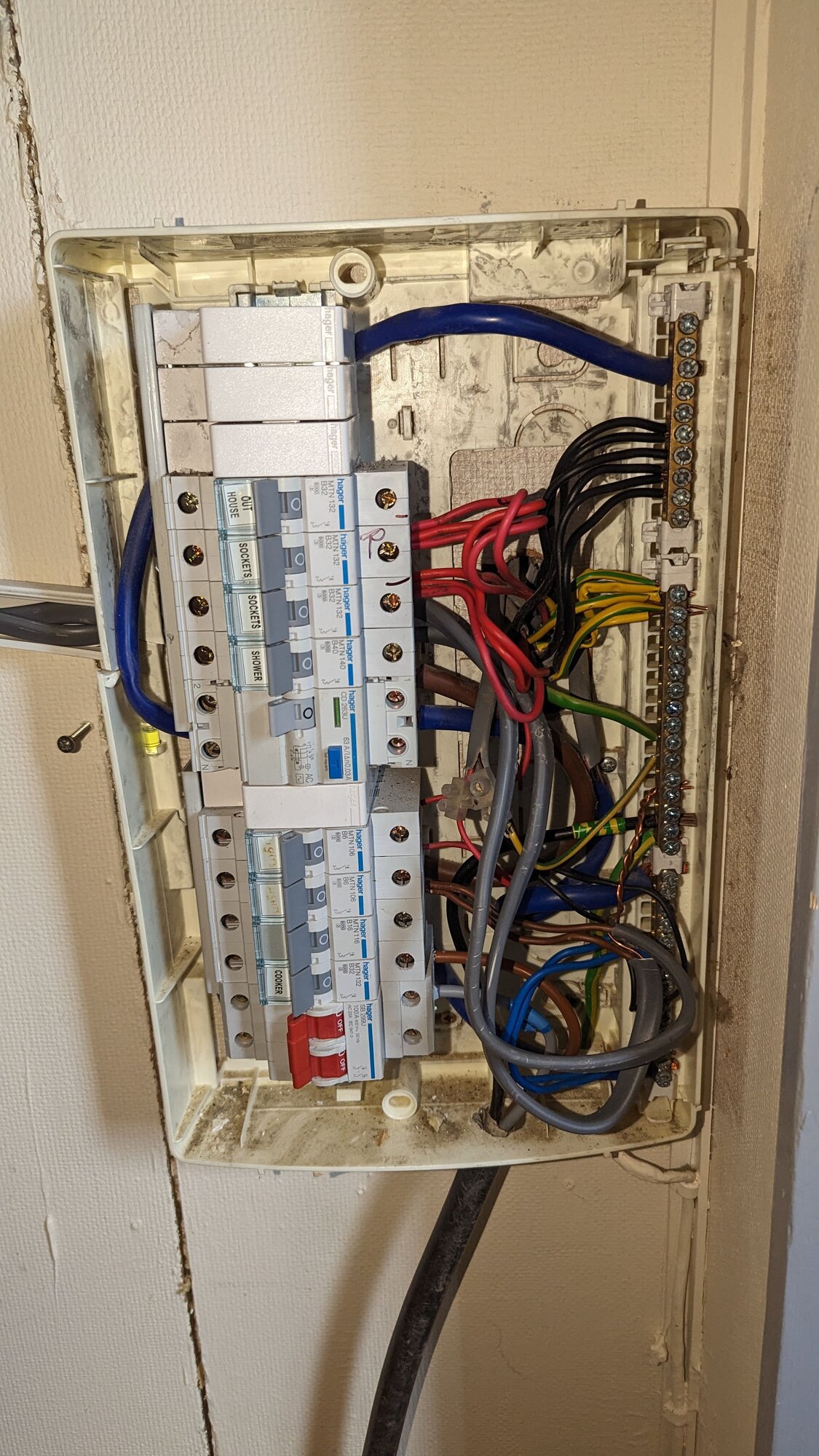

Another bit of a job helping someone out.
Just a observation whilst onsite.
