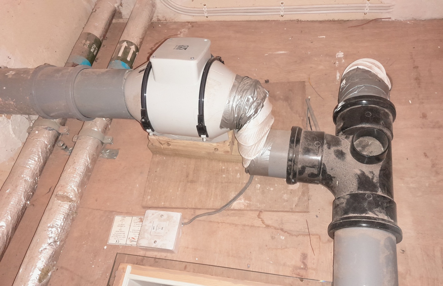

Wouldn’t have thought so....plastic feet on a wooden floor (upstairs) with plastic tap tails......I reckon wet pants took and old steel bath out and panicked
Maybe thought he got a belt off the bath only realising later he had smacked his funny bone on the waste pipe.

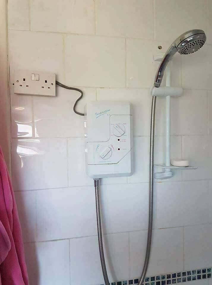

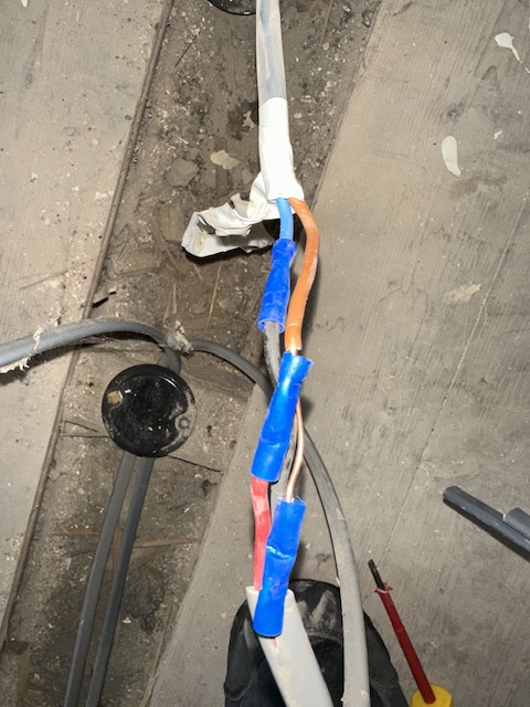

[ElectriciansForums.net] Dodgy trade pictures for your amusement! - 1 Million Views![ElectriciansForums.net] Dodgy trade pictures for your amusement! - 1 Million Views![ElectriciansForums.net] Dodgy trade pictures for your amusement! - 1 Million Views!Having my van repaired at garage, went to there toilet, not on the picture but above sink was water heater on plug top. Plug top was in sink.

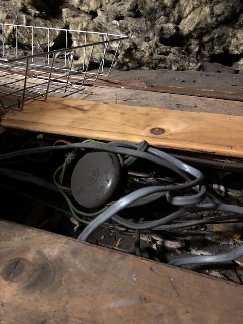

Doing periodic on farmers retail complex, started having a good look around to familiarise myself with the complex of small barn retailers, came across this (photo s) went and spoke to owner, he said been through separation and that supply is his ex wife s, [ElectriciansForums.net] Dodgy trade pictures for your amusement! - 1 Million Views![ElectriciansForums.net] Dodgy trade pictures for your amusement! - 1 Million Views![ElectriciansForums.net] Dodgy trade pictures for your amusement! - 1 Million Views![ElectriciansForums.net] Dodgy trade pictures for your amusement! - 1 Million Views![ElectriciansForums.net] Dodgy trade pictures for your amusement! - 1 Million Views![ElectriciansForums.net] Dodgy trade pictures for your amusement! - 1 Million Views!

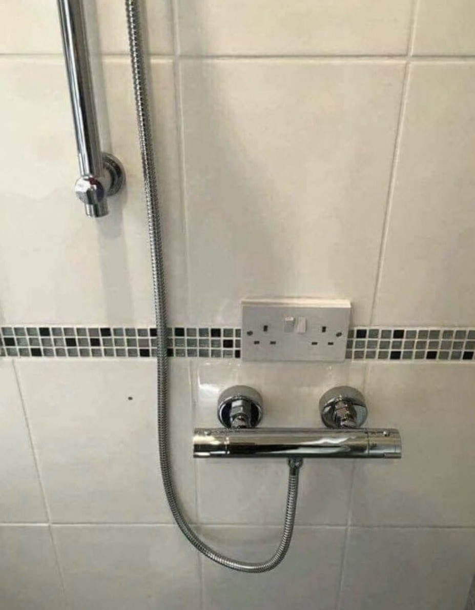

Bit of advice please,do you think this notch is big enough for the 4mm bonding?View attachment 55046
that's lateral thinking. sparks has used the notch cut by a wet-pants in the wrong place to save getting his combi drilll off the van.
