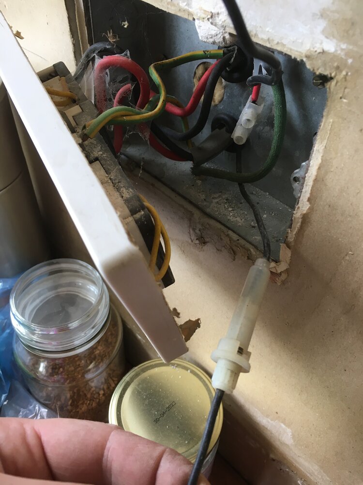

It amazes me what will still work, this install is probably 40 years old and apart from a newish consumer unit has not been touched. Still has the old coughtree swan neck outside lights and all sockets were the old mk type, mainly singles.
Snipped back the corroded wire and the tarnish didn't go much further that where it was exposed to air and damp. Surprisingly the insulation test came out ok as well! Re-terminated in a lovely wago box and put back into service!
