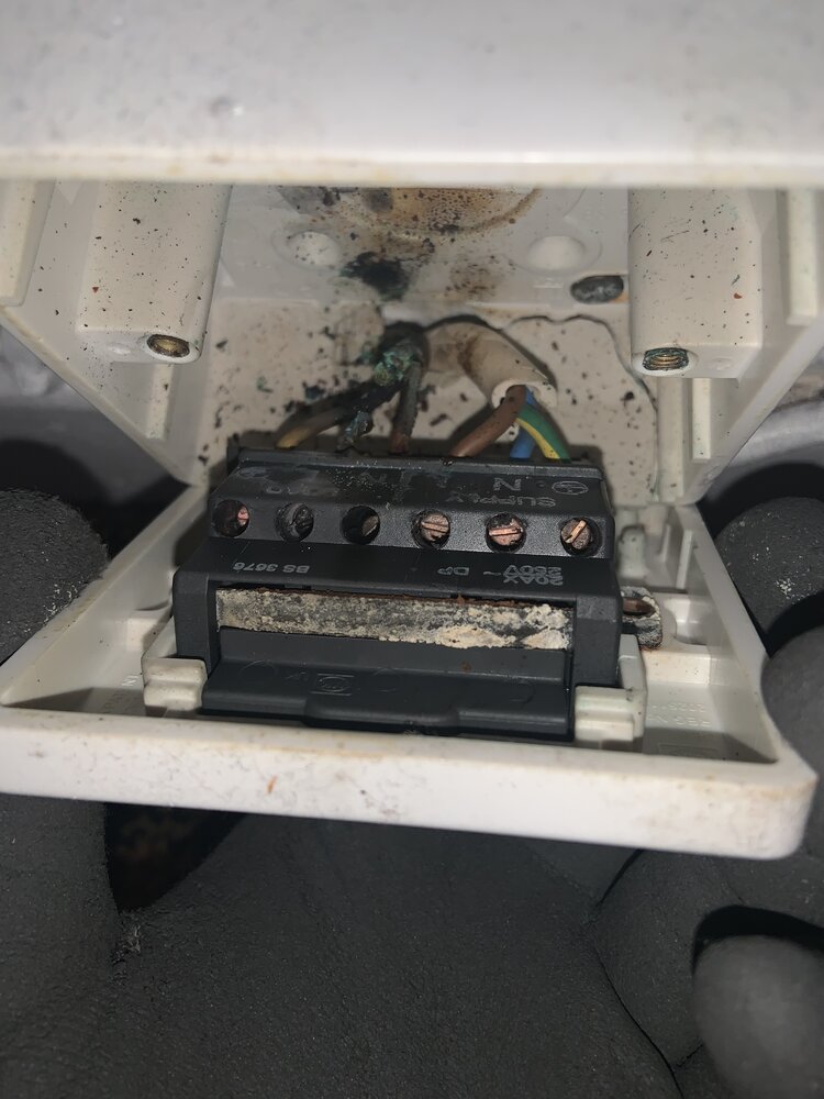

Chasing a bloody IR of 0.08 all day. Eventually found this, boiler had nicked the neutral when fitted aswell. Sorted it out and then had a reading of 0.14 ? found a RCD spur shortly after. Now 999MOhms all good. Had to do a joint in the old yellow insulation in shorts, looked like I’d been swimming when I came out
