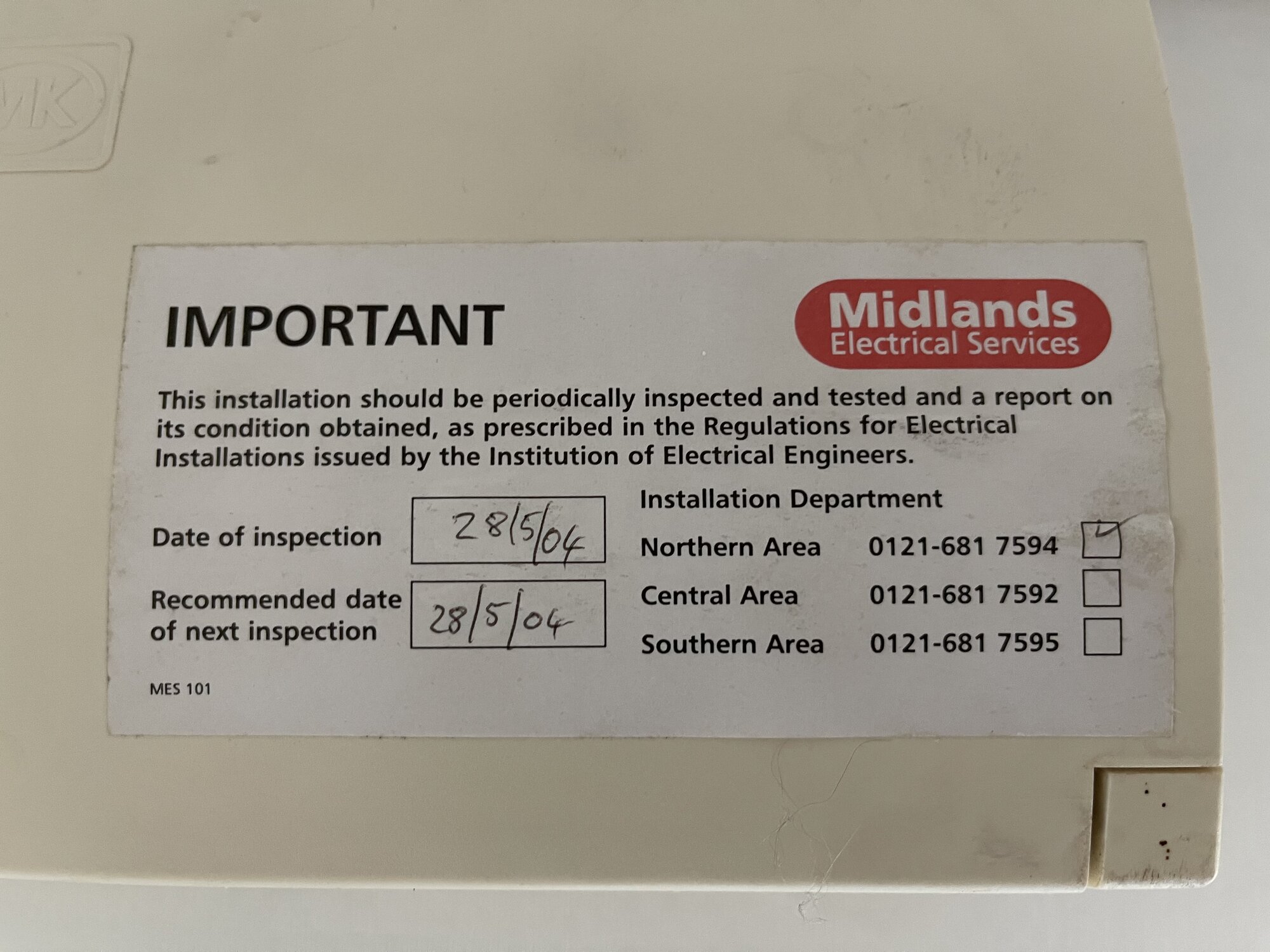

Got called out earlier to look at a cooker that wasn't working. A 3.4Kw unit that was installed by a well know UK chain with their own installation teams a couple of years ago.
They'd already had three warranty visits from them when they finally diagnosed the SFCU being the problem when one of their 'electricians' burnt his fingers pulling the fuse 13 amp out.
Swapped out for a cooker connection plate so hopefully no more problems.
It appears that the 0.5mm arc patch in the fuse carrier was the problem and not the SFCU they installed when they fitted the cooker... The rest of the SFCU was in really good condition, at least they used MK...

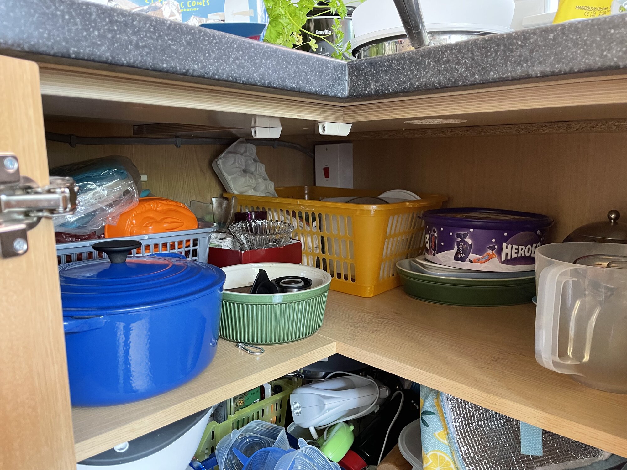

Joy - former shower, supply still live. Seems to be joined to RFC 'somewhere'

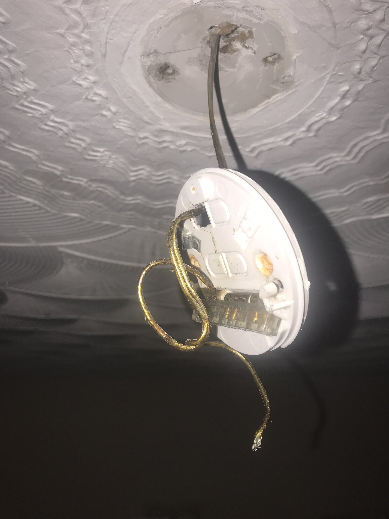

Now checking rest of extension. The fact he didn't understand ceiling roses is already evident.

Yes, beware is the word. It was fed from a separate RCBO now marked "Garage", and of course that also supplies the garage consumer unit, arriving there in 10mm SWA, location of joint not conspicuous.
