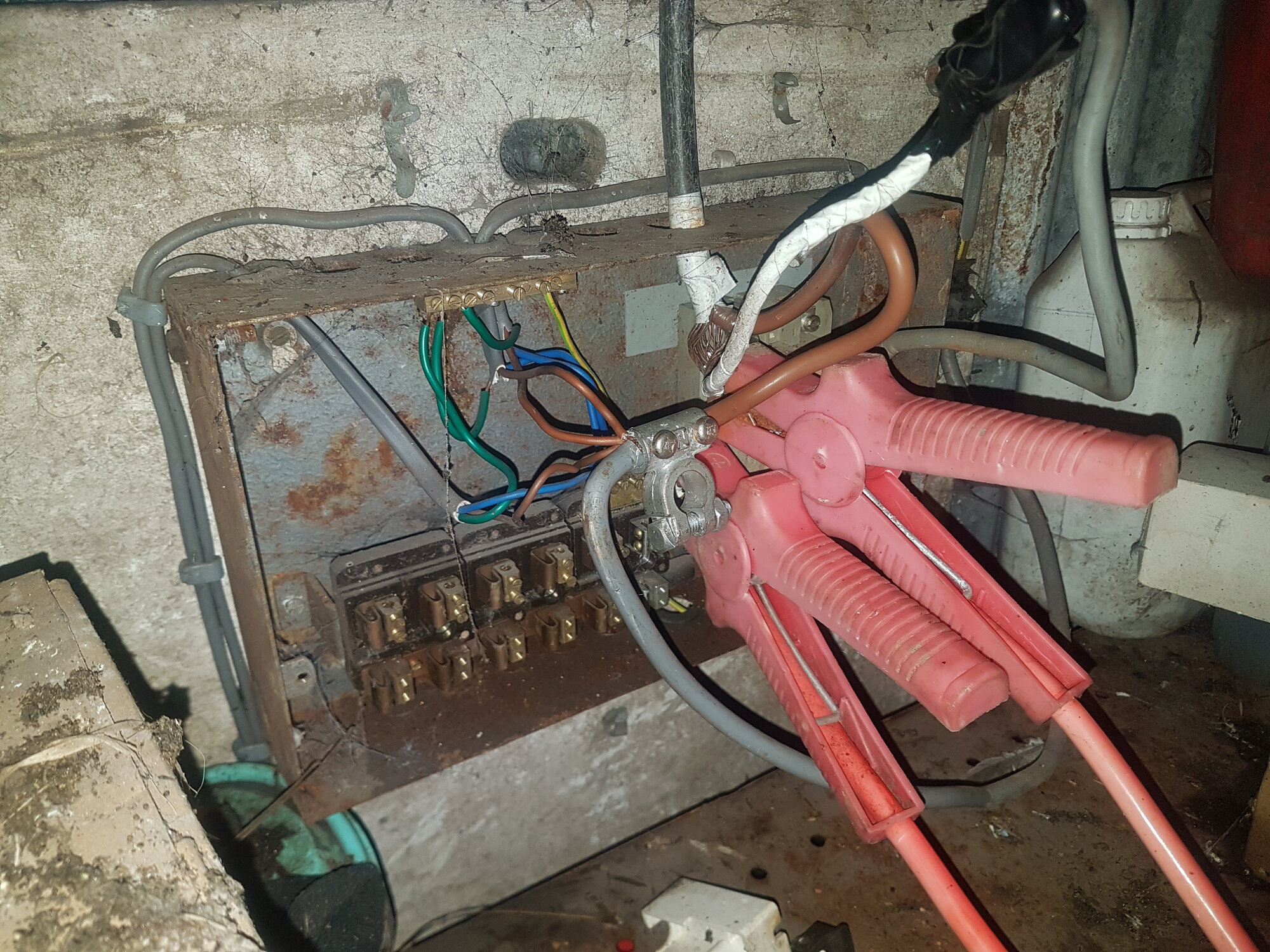

Right mess by anybody's standards, but I can't see anything that I'd describe as "a threat to life".
Replacing the covers on the trunking, and a few cable ties and clips and it'd look a lot better.
The tails with the join is the worst bit, although I thought it was floating Henleys with a bit of tape around them.
Tripping / entangling in the cables on the floor is quite an immediate threat to anyone going in to read the meters or do any work!
The photo is not good enough to check things though, might be floating Henley blocks, but looked like tape to me. Also not much sign of grommets on trunking, and to the right just below vertical conduit there are some wires that might be taped or bare, or maybe just a trick with the brown live crossing the blue and G/Y.
Also a suspicious lack of G/Y earths around the wall of meters, etc, but maybe part of trunking?
