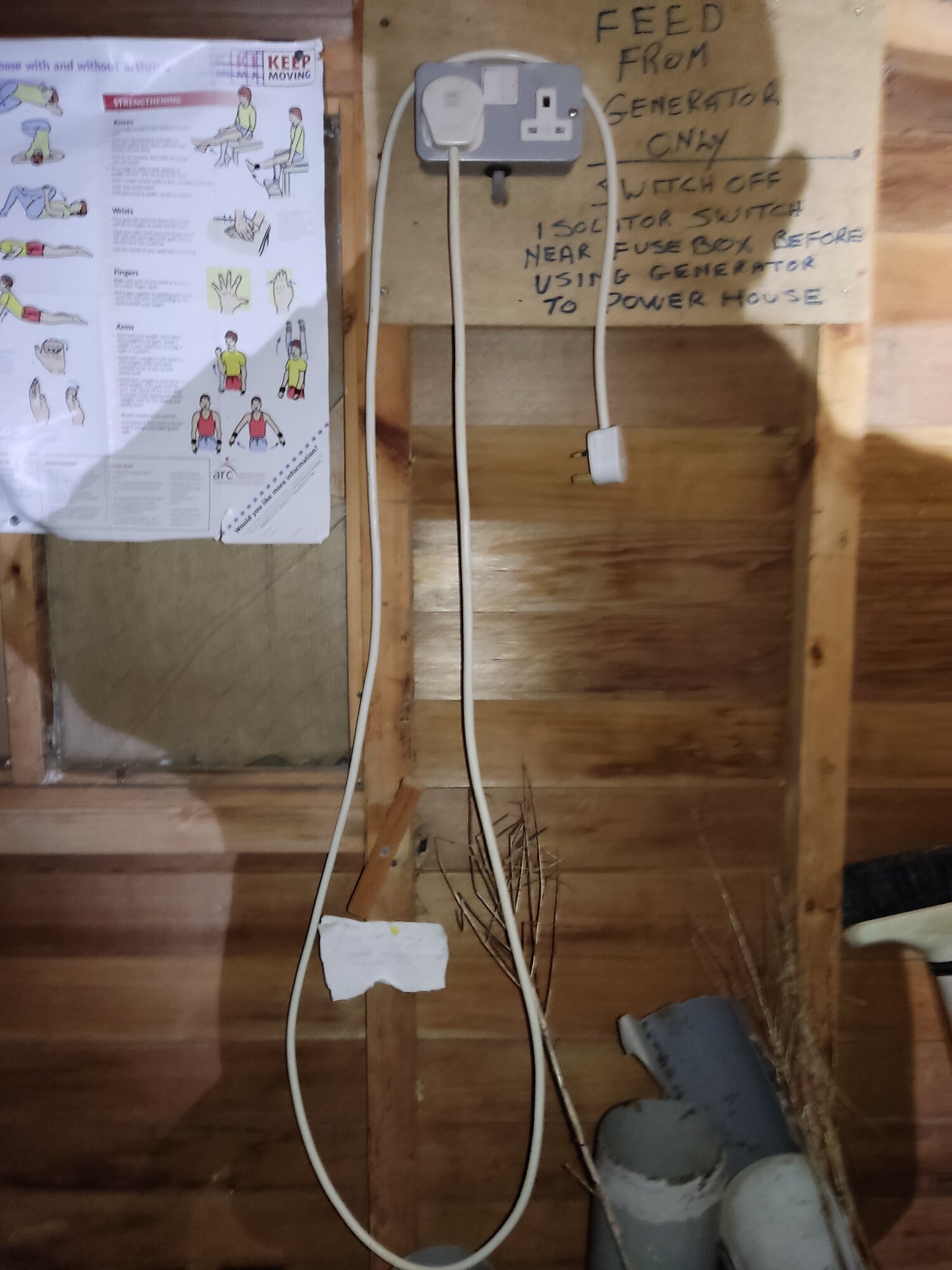

WOW,
the only time I have ever seen it done was a member of my family.
his theory was that it was ok because he knew what he was doing and nobody else would touch it.
it was difficult to educate him because he knew the danger but argued it was not a real risk because only he would touch it and he knew what he was doing.
Owner - "That's just an old connection, it's not live any more"
Me - "Um, I beg to differ"
