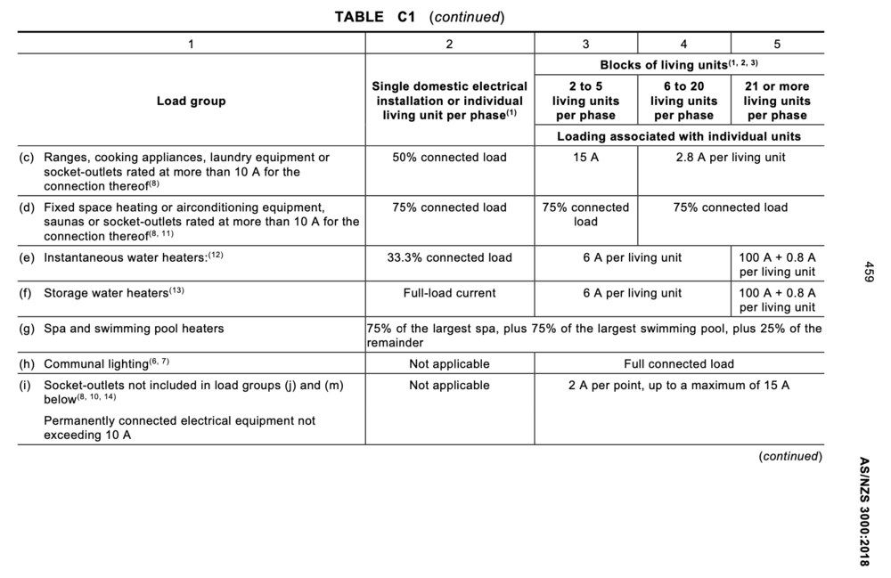

Hi
Can anyone let me know the new Australian/New Zealand wiring rules regarding small air con units in NSW. Do they need a dedicated supply?
I know in Queensland the rules have changed since Jan last year & any aircon depending on load needs its own dedicated supply is this the case in NSW.
Thanks
studying this now and yes depends on load, max demand etc see load group d in attachment that covers domestic but if it is commercial different table part. see the wiring rules if you can get a copy.
