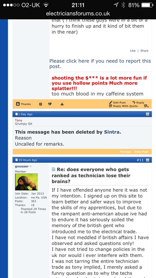

If I have offended anyone here it was not my intention. I signed up on this site to learn better and safer ways to improve the skills of my apprentices, but due to the rampant anti-american abuse ive had to endure it has seriously soiled the memory of the british gent who introduced me to the electrical trade.
I have not meddled if british affairs I have observed and asked questions only!
I have not tried to change policies in the uk nor would i ever interfere with them.
I was not tarring the entire technician trade as tony implied, I merely asked a funny question as to why the techs missed such a basic issue. (read the reply while i was at work and since then it has been removed)

As my question has been deleted I’ll ask again.
Why come on to a British site for information so you can teach your “apprentices”? A site where most work to BS7671 and not the NFPA-NEC
This is the first time I’ve noticed you even mention training apprentices. If you’re using our containment methods in the US I’d be interested to know how the NEC inspectors rate our methods.
BTW in anticipation I took a screen shot of my deleted post “just in case”.
They haven’t got time because they’re to busy deleting posts.
The last time I had a post deleted I was sent a PM which stated the moderator hadn’t the time to read the entire thread. My response was not having time to do a job properly was no excuse for taking unwarranted action. I did get an apology.
