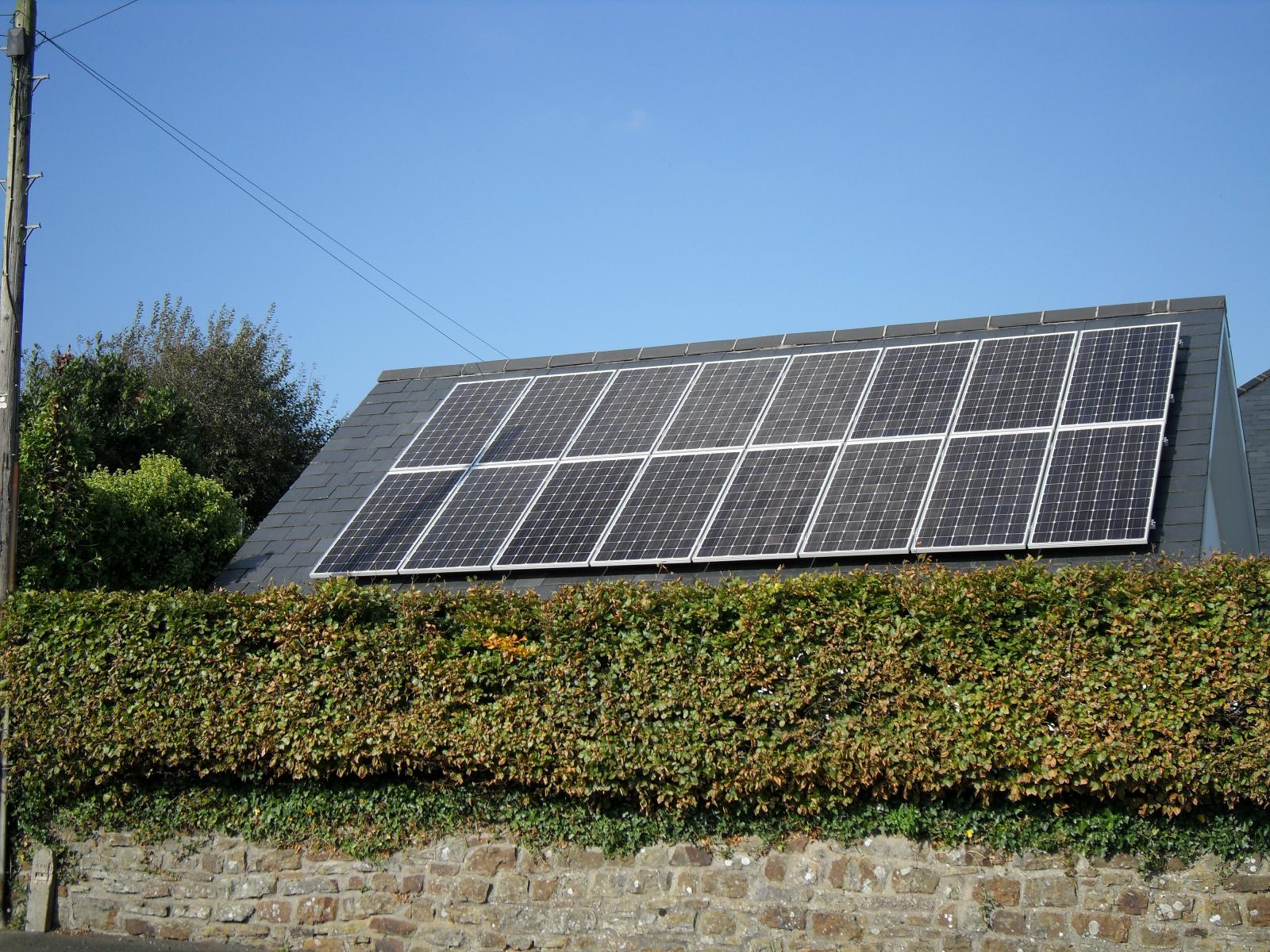

I thought I should come back on here with some real-life results for those interested. PV system now beautifully installed and up & running courtesy of one of the contributors to this forum.
I took this photo today at around 2.30 pm. The array is split L & R, 8 panels each side. They are 200W Suntechs feeding an Aurora Power One (dual tracker) - a 3.2kW system.
You can see that the telegraph pole is casting a full-height diagonal shadow over the bottom left panel, and around half way on the adjacent panel to its top-right. Bright, sunny day, although slightly hazy.
Outputs: RH array - 1170W and LH (shadowed) array 940W. (Peak output for the day - probably at around midday, was just over 2.5kW, which would have been split pretty evenly between the two as no shadow at that time.)
A couple of minutes later the sun went behind a cloud and both sub-arrays obviously dropped significantly in output as expected, and were nearly identical - 319 and 309W respectively.
I hope this is info is of interest. I can't analyse it too much myself as I am just a (happy!) customer not a PV installer. However, it strikes me as though the detrimental effect of the shadow isn't as great as I feared. Certainly the system as a whole is exceeding my expectations. Obviously the situation will become somewhat worse over the next few months as the shadow will cover both rows completely, before not becoming a problem at all over the main, shadow-free, summer months.
I am happy to provide updates if it's of interest. This kind of 'real-life' result is pretty much what I was looking for myself when I first came on here.
(I'm not sure of the forum etiquette as regards naming the installer. Certainly it is someone I am more than happy to recommend :winkiss:. I'm just aware that the purpose of the forum is to assist and not to advertise - certainly I received excellent help and advice from a number of people on here, so thanks to all. I guess, tho', that if asked by PM there should be no reason for me not to give this info - it is little different to a passer-by seeing my install and asking? Please advise if different.)

That's very interesting data Scooby and I'm really pleased to see it published. I don't know if this analysis is a reasonable one but I'll offer it and see if the logic makes sense to others:
If we split the array into two halves and assume that the RHS is the reference. On the left hand side one panel and about a third of a panel are struck off by the telegraph pole. If we assume that each panel has 3 bypass diodes that means that 4 diodes are operating out of a total of 24 in that half of the array. Thus, the left hand panel is running about 83% of the harvest of the right hand side. Your figures would suggest that it should be about 80%. Either way, pretty close.
Thus, the diodes are working. I guess that in low light the pole has a more fuzzy effect and doesn't come into play.

Great to see the system working so well. It will be interesting to hear some updates so that we can analyse just how much impact the pole appears to have on the array. 1170w and 940w surprises me. I have always been surprised by how much a simple scaffold pole affects a system so the slight drop in yield is not what I'd expect.
Thanks for your replies - I'm pleased it's of interest and I'm happy to update it when conditions change. If there's any particular conditions which are of interest, Worcester, please let me know and I'll do my best to provide them.
Series530, I get the gist of what you're saying! My concern before having a system installed was whether by-pass diodes would be effective. My install suggest they are - which is a relief. It'll be interesting to see how having two panels in each sub-array completely zonked by the shadow. Also, when the shadow hits a panel on both arrays - that happens at around 15.30, I think.
