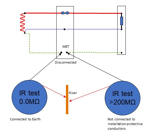

Hi all.
Looking for opinions on here.
I’ve identified during an eicr that a dry rise pipe used for firefighters in the building is in fact an extraneous conductive part and that it is not bonded back to the MET.
However what I’m questioning is it’s accessability to be touched in the event of a fault.
Pipework is installed in boxing with a key for an access panel for the riser water inlet to be used for the firefighters.
Only person with access is the building manager.
What’s people’s opinions does it require protective bonding or is it deemed not accessible to touch and that’s the end of the matter?
It’s worth pointing out bs 7671 doesn’t mention the fact it needs to be accessible however it’s common sense that says it needs to be if your going to be in contact during a fault between say an exposed conductive part and said pipework.
Thanks
To add the dry riser pipe comes up from the floor in metal and is separate from the cold water pipe entering the building in plastic.
A completely different service it seems.

The OP started off stating there was an IR of 0.00 Mohms between the riser and the MET and that there was no continuity between the riser and a known earth.
I stated that 0.05 ohms is the maximum resistance for parts bonded to the MET.
In the OP’s case, I would use a low ohm meter to determine whether the IR reading of 0.00 Mohms is below 0.05 ohms.
By saying no continuity do you mean low ohms measurement between MET and riser is off the scale (Im guessing greater than 200 ohms)
But insulation resistance between MET and riser is 0.00 Mohms.
Is that right? otherwise the information contradicts itself because no continuity wouldnt give a reading of 0.00 Mohms and maybe where the confusions is.
The key point of the original question I think is is there an exposed conductive part, a live part (even if covered), or another bonded extraneous conductive part within 2.5 m of the hatch giving access to the riser.
The majority of the riser is inaccessible and therefore cannot introduce a potential; if the access hatch is not near any conductive part that may become live and can be simultaneously touched by a person or livestock, then the part at the hatch will also not be able to introduce its potential into the installation and bonding would not be necessary.
I think what Ian1981 is saying about measurements is as described in the below diagram. The riser is connected to true earth, but not connected to the installation protective conductors.
