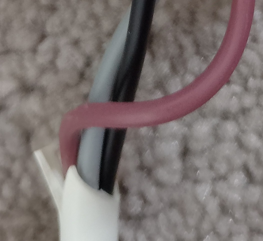

Was fitting a radiator with an electric heating element (the towel rail heater type) and obviously it makes more sense to connect as a fixed appliance, rather than via a standard plug.
However, flex with a standard (moulded on) plug is what it came with - odd, I thought, given that it's a towel rail heater and who's going to be able to plug that in in a bathroom...?!?). So obviously I cut off the plug ready to connect to a switched fused spur setup.
But inside the innocent looking outer sheath are 3 colours I've never seen before in UK flex: brown, grey and black! I didn't think that happened outside of 3 core+E cable?!?

Is it copper conductors
No there's nothing CPC-esque at all! And yes it does need one!
I mean, I guess I could work out which one is the CPC by doing continuity test on all 3 in turn to exposed metal parts, and then hope for the best that the (digital) thermostat element isn't picky about polarity, but it's hardly ideal!
Is there a double insulated sign on heater,I've seen heaters come with a black pilot wire but never a 3 phase coulered cable.i suppose you could see if any of the cores are connected to body of heater
No class
No class 2 symbol, and no access to connection (it's in a tiny sealed thermostat head, no like an open bar/convector heater)
No it's not ideal atol.do you have the make of the heater or is there a customer service number you can phone.
Yeah, I guess I will call the supplier.
Although I can see problems with that in that it was bought from a fancy radiator supplier, who then (it appears) source the electric elements separately and provide with those to be fitted. The radiator is basically being converted from central heated water to electric via the screw-in element.
I'd quite like to know if I can let rip at them for non-compliance, or if I need to tread carefully for help 🤣
No class
I quite often phone tech help on there products and there normally pretty helpfully and usually I get straight thru.did you say the element was fixed or can it be replaced with a uk one of same wattage .you could send a pic of heater and element if you can
Throughout Europe the earth wire is identified with green/yellow. Is there a brand on it?
Thanks, yep, will try them tomorrow and see what they say. And yes, as the element isn't integral to the rad, worst comes to the worst, it seems like that part can be changed out fairly easily. (Seems ridiculous for someone other than the supplier to have to foot the bill for that though!!)
would never have known it was non standard colours until the plug was cut off.
Can you continuity test between the cut-off plug and the remaining wires still attached to it, or did you cut it so close, theres no flex left to strip?
Ooooh. Now that would've been a good idea...even though I did cut it right at the plug...but instead I decided to shear off the top of the plug to look inside but that was hopeless (couldn't see anything and destroyed everything in the process 🤣). Silly move on my part!!
In fact that's not just a good idea, that's an effin' brilliant idea and now I'm furious with myself for not thinking of it before I mangled the plug 🙄😡🤣
