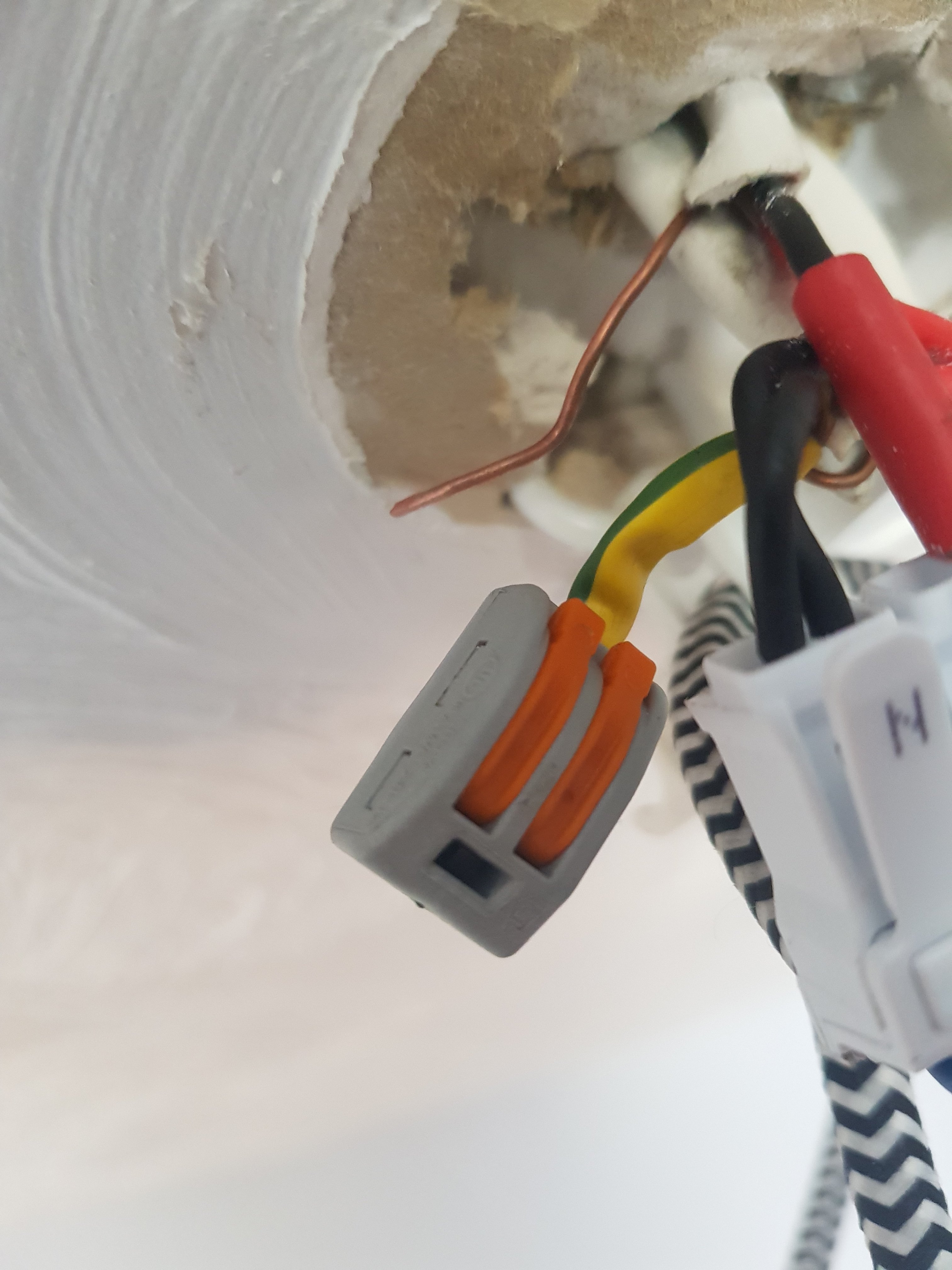

OK update everyone:
I have wired the new pendant and it works perfectly, however, two other lights in the house now do not work (room opposite mine and toilet, next door). I have wired it the same way as before, so no idea why this is.
All 3 loops are in a WAGO and as well as the earths.
Only thing I can think of is that I used a two way wago connector to put 3 earth wires in... Would this affect it i any way?
Also whilst I order a 3 way one, can I do anything to get the other lights on and sacrifice mine as people are annoyed at me now lol.
AS A GUESS, I'D SAY THAT ONE OF THOSE REDS IN THE 3 PORT WAGO IS NOT MAKING PROPER CONTACT.

Possibly outgoing Line feed to last 2 lights not connected in the 3-way Wago, either not making proper contact as Tel says (e.g. not stripped to right depth and/or not pushed in properly), or copper in cable broken (e.g. due to too much bending).
Or similar issue with N return in respective connector.

Feels so good to actually do it myself haha. Thanks guys for all the help and for understanding this DIY noob, but saved me money and hassle!
It was a problem with the Neutral in the IKEA connector as SJD stated.
Once again thanks guys and happy wiring ;)
