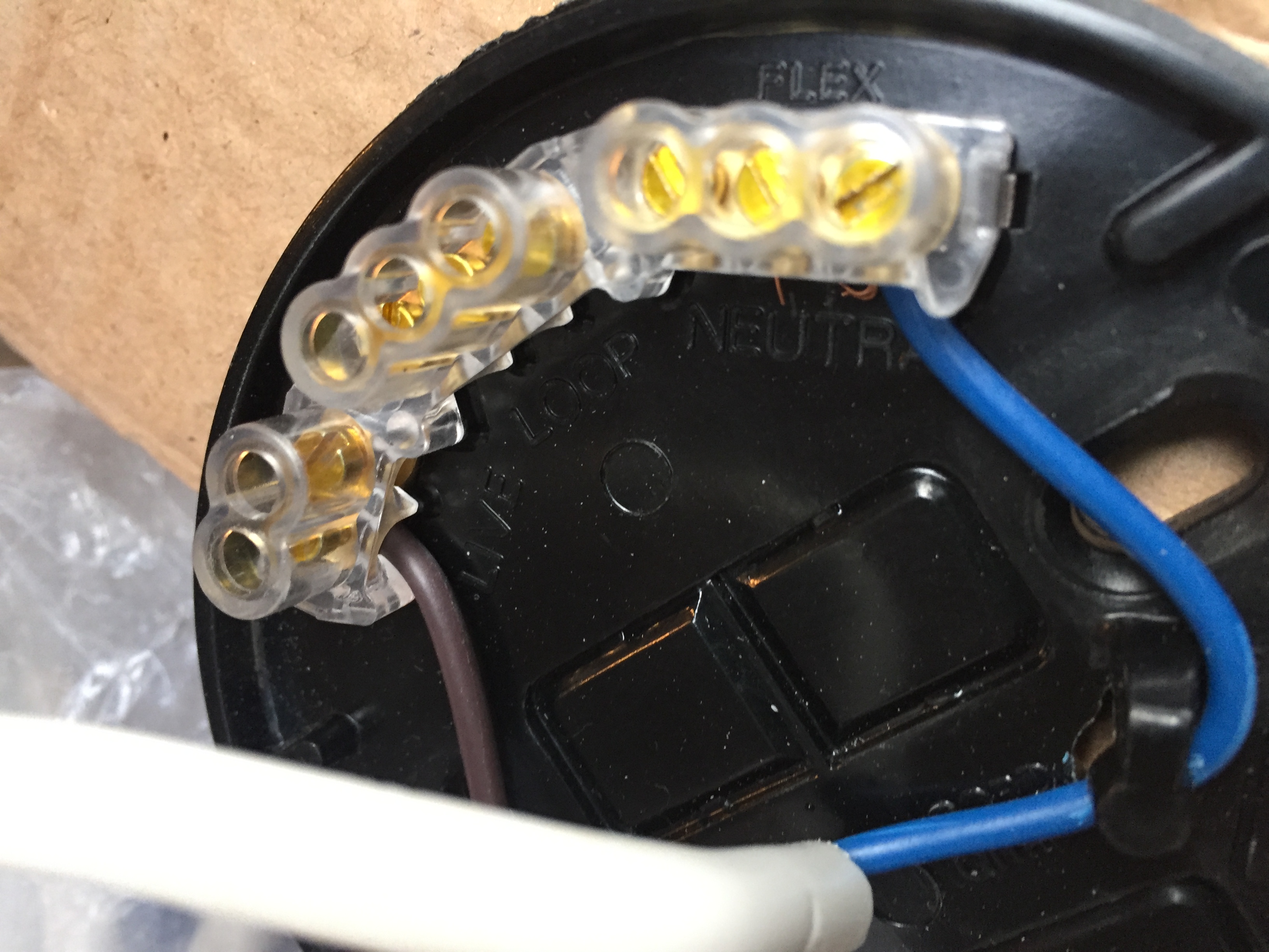

I can upload deta pendant if you like?
But I assure you the flex don't come crimped
Please do, is this a new pendant that hasn't been shortened or doesn't have specific terminations designed for fine-wire, if it is new and does not dress the fine-wire then it is probably in breach of their own BS regulations for such products... I am interested to see your upload as the last Deta I did was dressed cable ends but as they are uninsulated crimps you sometimes need to take them out to see the crimp.

Back on site tomorrow so I will do
And I use deta all the time
Yes that one where no definition is given for multiwire, fine wire or very fine wire. To me that covers all conductors beyond solid core does it not. Whatever it refers to the requirement is to fit suitable terminals or suitably treat the ends.
The terms are defined in other British standards and if you look at the data sheets for the cable it should tell you what type and class of conductor it is.
I will do some digging as to which standard cover the likes of deta and volex for pendants etc, but you can visually see the strands are not clamped correctly in those screw terminals, the only positive on it is the fact the current is so small compared to the ccc of that cable that even a poor termination with the fine-wire wouldn't give rise to an issue.
