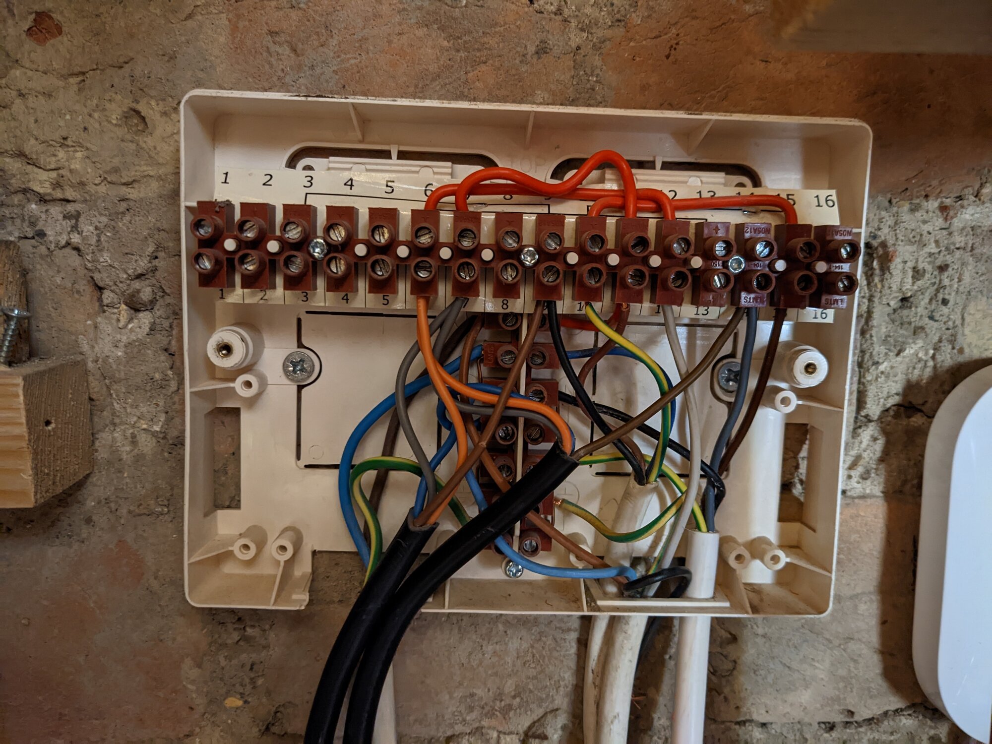

You want a competent Electrician to check the electrical side of things

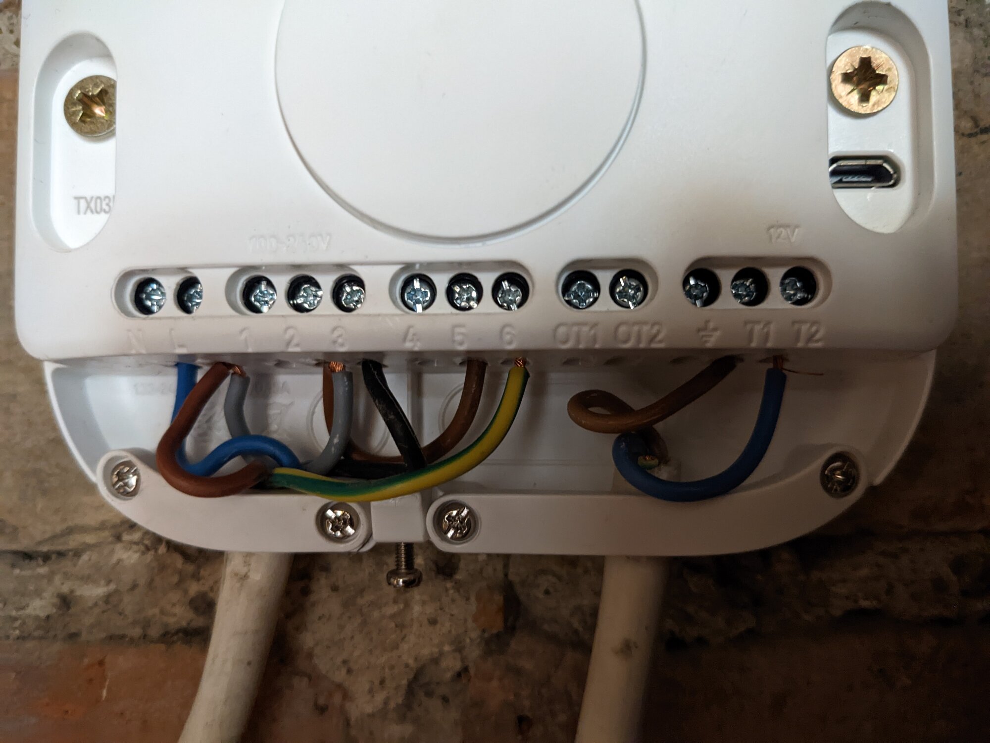

Do you have any photos of how it is connected inside the boiler?
Of course. And happy to take more if needed - just let me know..
I can see a dangling black cable again.. and nothing on 3 or 5.. and no bridge anywhere..?
See below!

ALSO see below diagram as shown in manual for System Boiler - there is a bridge b/w 3 and 4... which mine doesn't currently have.. 🤔
