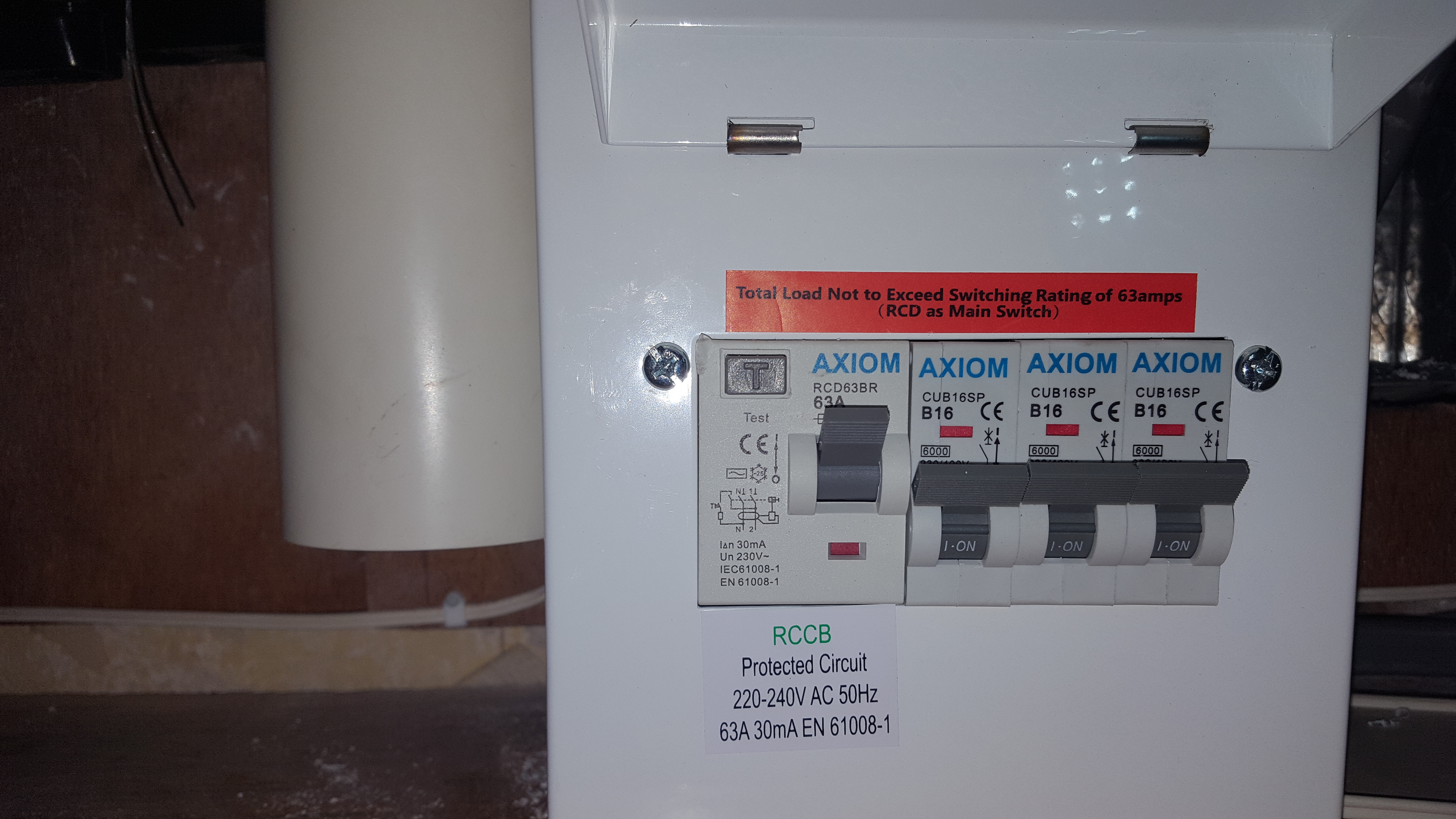

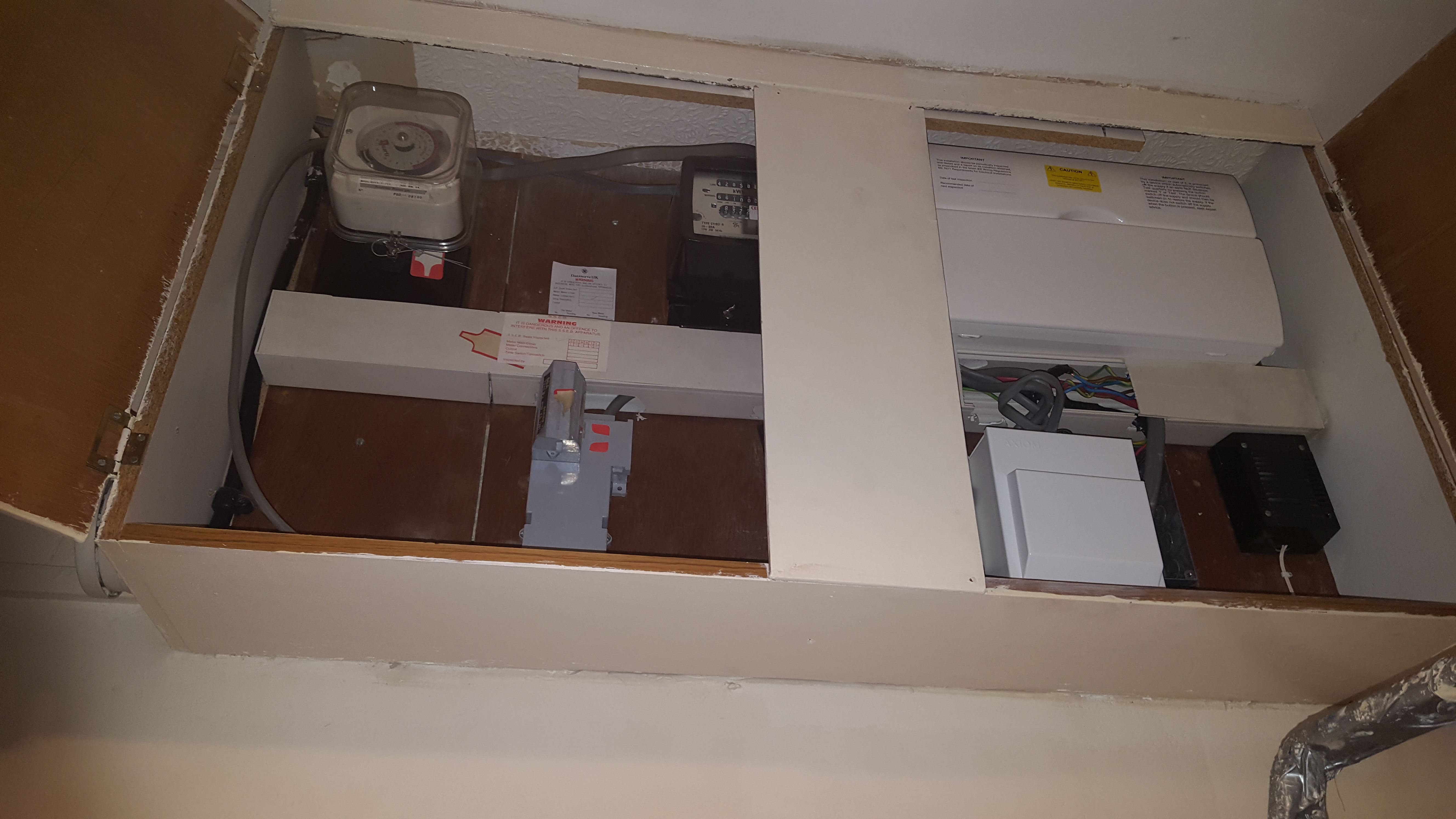

Hi everyone,
I just had my distributer box upgraded to an RCD box, and I was wondering if anyone could advise me on the quality of the work done here. I know that changing these boxes is a nightmare to do, and truth be told our wiring was a mess before, but for the price we payed I don't believe there should be electrical tape and exposed wires coming out of the box. Also you can see the housing for the old night electricity box which they have decided to leave and they also chose not to cover the channel with all the exposed wires. I'm just curious to see what this forum's take is on this work, and if it was worth the £700 I payed for it.
Thanks!
(This is my first post, so if I am in the wrong category I apologise)

I attended the property this afternoon and carried-out a Visual Condition Report. I've uploaded the redacted document for your perusal. I also carried-out a Ze test (fine), RCD trip times (fine) and Zs tests on all the sockets (not fine). I also did end-to-end tests on two RFCs. The house ring was fine, but there is an issue with the kitchen ring. Someone (Kevin the kitchen-fitter, no doubt) has made alterations which have resulted in a complete loss of continuity of both CPCs at one of the kitchen sockets. Zero volts between live and both CPCs. So, whoever did the board changeovers either knew about this fault and simply ignored it, or, as is much more probable, didn't do any testing prior to installing the new boards. All the issues that I found are detailed in the VCR. I look forward to reading your comments!
Now for the moment that you've all been waiting for ...... the photos:

The customer informed me that it was a wetpants who did all of this. I've yet to decide a definite plan of action to rectify this lash-up, but I'm inclined towards ripping the lot out and starting again from scratch using a Hager unit instead as I absolutely hate BG boards. I think that the Axiom 3-way garage unit that is being used to supply three off-peak storage heaters should be replaced by a better-quality unit with 100 amp main switch and RCBOs. I propose to relocate this board further to the left so that I can utilise the adaptable box that is being obscured. I could then take all those bad joints inside the box and crimp them or use Wagos. Your thoughts please guys and gals.
As we all had already anticipated, the customer did not receive an EIC.

A very sensible and thorough use of a visual inspection form - the customer could almost copy and paste as his justification not to pay, or to pay a hugely reduced sum for the "work" undertaken.
Trading standards should be informed too IMHO
Good man.
Nice work! Hope the customer is satisfied.
Although comment would be you're only supposed to code non compliances that affect the safety of the installation, so lack of labelling could only be an observation could it?. Also no CPC continuity would not need further investigation in order to classify it, although investigation would be needed to repair. Should just be coded straight away.
