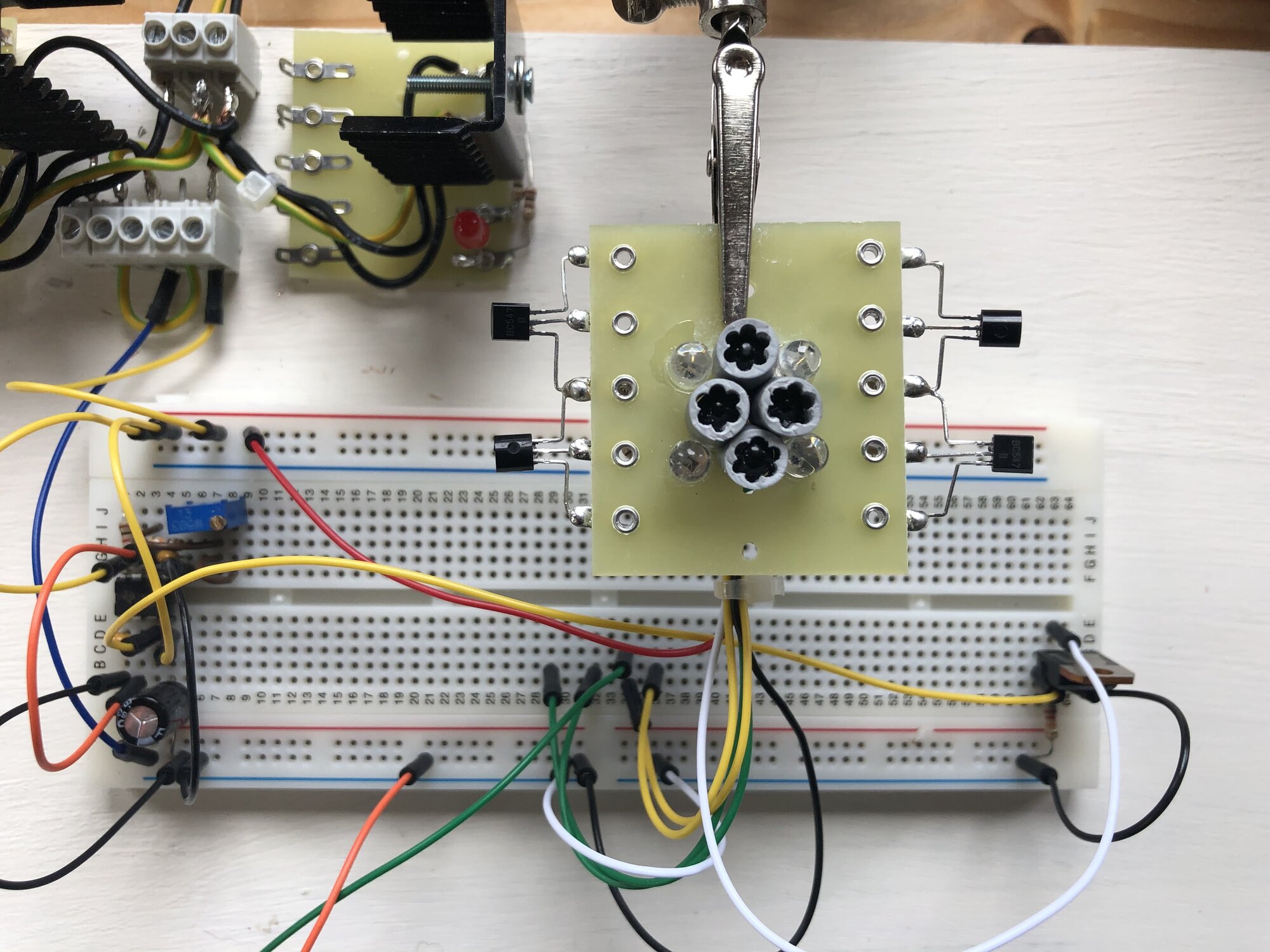

How does the remote perform when there is sunlight or high ambient IR in the room? I am interested to know because that is what I am tackling with my Version 3. I have made slow progress this week but some nevertheless as I illustrate in the attached video which shows 5, 0, 12, -15V regulated power supplies and the 555 clock running at 25kHz to run my logic and pulse the LED sensor illuminators.

q12x I thought you would like to see the shape of the voltage waveform produced by each of the four black 940nm photodiodes when they receive infra red light from the four LEDs pulsed equally on and off at 25kHz. You can clearly see the effect of the reverse biased photodiode‘s capacitive depletion layer and resistance producing a CR time constant which is too long to respond immediately to the ir light being turned very quickly on and off. You can make out the classic CR circuit charge and discharge exponential curves. One way of improving photo response time would be to increase the reverse bias which widens the depletion layer and thus reduces its capacitance thereby making the time constant shorter. The sensor array is picking up the side of the scope.
So, one might have expected nice crisp straight sided pulse outputs from the photodiode but other factors are at play causing waveform distortion.
