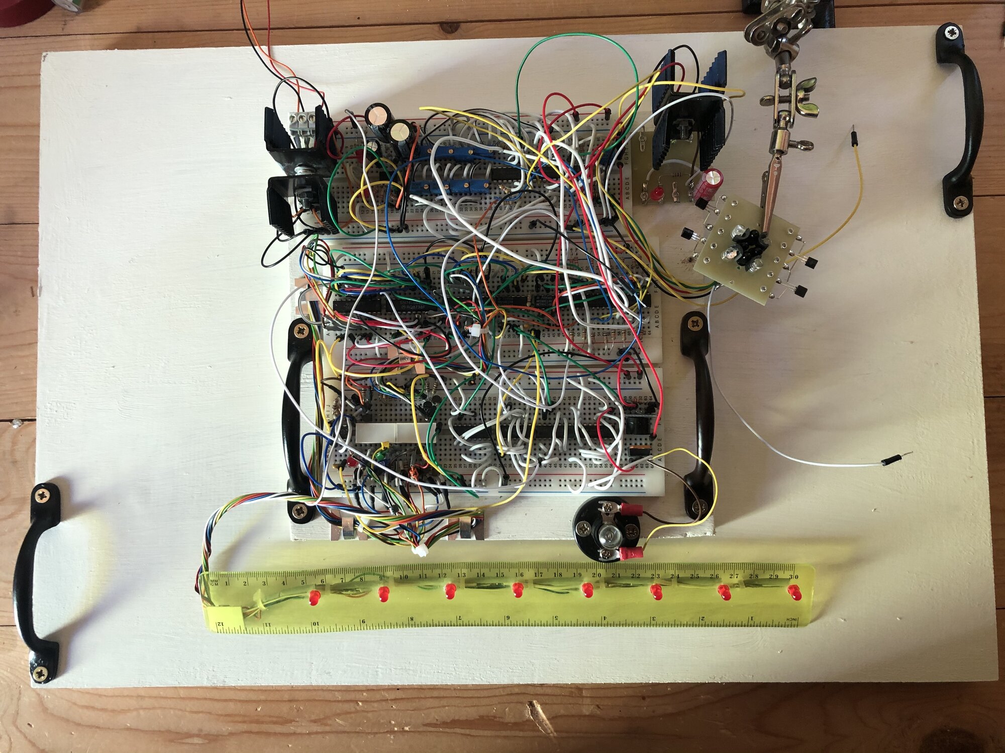

You have been more industrious than me. I have at least made a breadboard for version 3 which is bigger. You can see the 850/940nm ir sensor array.

If you are happy with the functionality you get from the breadboard right now, it is time to make it on fiberglass board. It's probably a good advice for you, to make it as a definitive project. And dismantle everything you have here on these breadboards. I did the same. Remember the movie where I presented the remote control receiver? It was breadboarded. Now is gone, breadboard is clean again, ready for other experiments. But I made the receiver module in this time, unfortunatly with the same opamps on the breadboard because they were the only ones I had.
