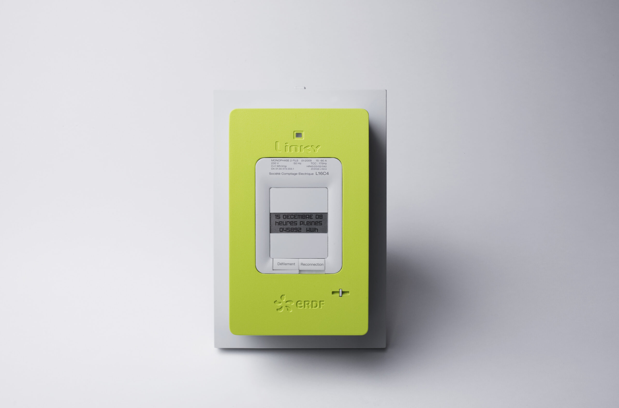

12 - I did a reverse image search, and came up with "Smart Meter" which looks very similar.
