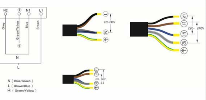

Hi all
I just had an electrician around to install a 6400W induction hob. Honestly I'm a little worried as to the job done. Also I noticed some weird wiring done (for the previous owners of the house I guess) that looked very suspect to me.
Basically this is the issue. The kitchen has one ring (strangely shared with some of the bedroom sockets!) for the sockets (32A breaker) and another separate circuit (I have no idea if ring or radial - I assume radial?) for the oven and hob.
The oven is connected to this through what looks to me like a 20A switch (the oven is rated at 4400W). The hob seems spurred off this on (what I at least hope is not less than) 2.5mm.
The new 6400W induction hob's wiring diagrams give two options. a 1L/1N and 2L/2N wiring options. The electrician opted for the 2nd option and wired the first part to the hob circuit off this existing spur (which had a 13A switch, now replaced with a 20A one) and the second hob circuit to another 20A which is spurred off an existing spur to the kitchen ring main.

For reference, here's the manufacturers hob wiring diagram:
[ElectriciansForums.net] Induction hob wiring
The electrician did the last one, connecting L1/N1 to the cooker circuit and L2/N2 to that spur off the ring.
Btw that diagram I posted above has an error (L1 and L2 seem to be reversed in the diagram). The manual has the fixed version; the electrician did as per the diagram in the manual and not as per the above upon realizing that it was wrong (and in effect connecting the cooker and ring circuits together!)
Quick google search doesn't reveal any installation manuals, but I'd go for (one supply) connection to Live & Neutral (& earth) to the terminals shown on the left hand diagram #3.
Please DO NOT connect a single load to 2 circuits - a VERY bad idea, and extremely dangerous

The hob should be OK to be connected in with the 32A supply for the oven using the first diagram with the L1 and L2 teminals linked and the N1 and N2 terminals linked.
To have to independently isolated supplies to one appliance could be confusing and dangerous because if someone was working on a faulty part, isolated a single switch and found the faulty part was off, they could then start opening up the equipment not realising there was still a live supply present, though they would have to be missing out on a lot of standard safety practice.
