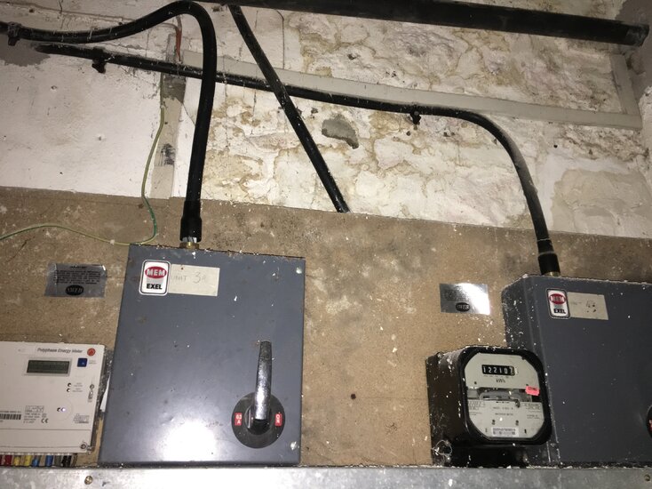

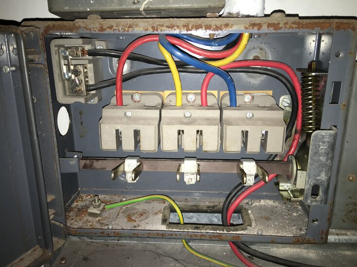

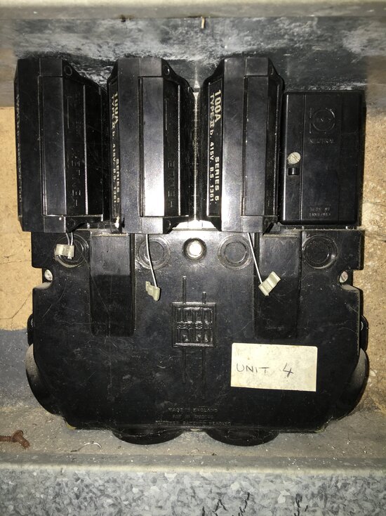

Pictures here hopefully, here’s the cut out and isolator in the distribution room which happens to be on the opposite side of the wall to our unit, and the internal view of our isolator switch in the unit.

The isolator switch that is open is in our unit, the 3P & N supply cable in the top is from the DNO isolator next door in the meter room, the grey bit on top of the switch is not trunking - it’s the cover for the rewireable fuses on the single phase board, the 3 phase board has been removed from our unit hence no cables on the outgoing RYB phases, the single phase tap off the yellow is to a single phase rewireable fuse consumer unit, the earth cable you can see in the bottom comes from said single phase consumer unit, which incidentally is where the main bond to the cold water pipe is, the hot water currently has none nor does the steel mezzanine floor.

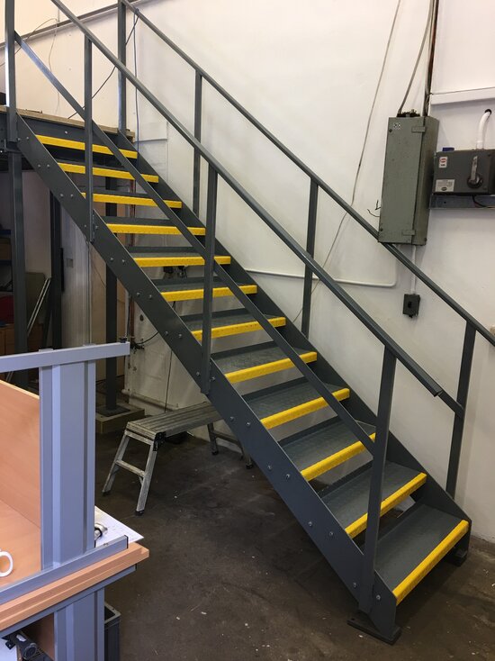

Managed to get hold of our chap but he can’t get out until Monday so I’m interested in any advice before then, I know it’s difficult, here’s a shot of what’s in the unit - the 3 phase panel has now gone as it was snagging the stairs
