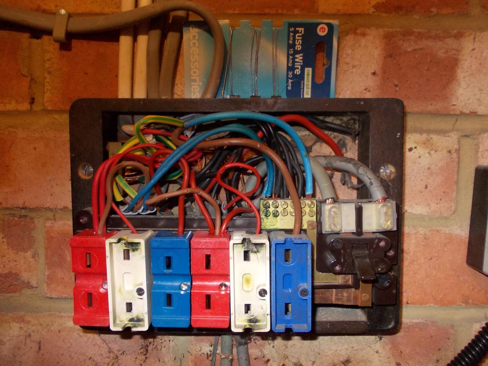

I'm guessing many other domestic sparks find this is the most common situation they encounter when doing a distribution board upgrade -
The terrace or semi-D with a classic Wylex 6-way re-wireable fuse board ... with some additions gathered across the years.
I try to get somewhere upwards of £350 to replace a board like this with a 10-way dual RCD CU, including upgrading tails and main earth. Not included in price would be fixing any problems found during testing, installing main bonding if not already present, etc.

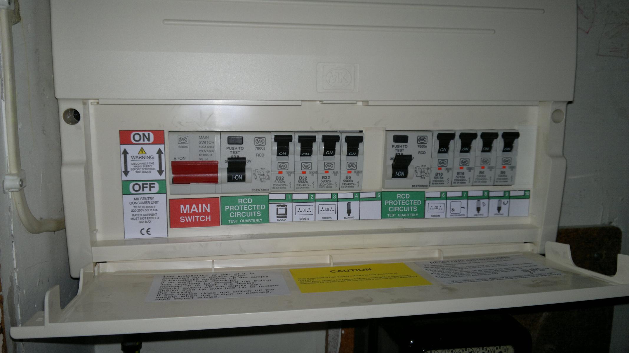

I came across this today:
Installed last year, no cert, no building certificate, no RCD's except the RCBO's for 2 circuits.
The best bit was a scribbled note saying that suspected dual suppply to the lighting circuits - which was true as I had to trun off 2 breakers to isolate the downstairs lighting circuit.
The icing on the cake - the insulation is falling off the cables!!
I do wonder sometimes.

Methinks you must have posted the wrong picture .... that MK board looks pretty standard to me!
