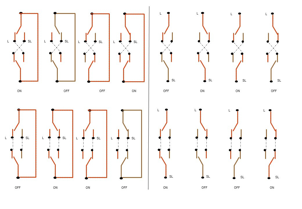

Hi have AM2 next week and just need some help, 3 phase TP+N board, two way and intermediate lighting circuit with 3 switches obviously and one light, doing a global IR test, the lighting circuit say is on L1, so I’m testing all other circuits at once too do I have to switch my switches for every one of these tests
L1-L2,L1-L3,L2-L3,
L1-N,L2-N,L3-N,
L1-E,L2-E,L3-E, N-E

I have also attached an indication of when three way switching conductors are connected to the supply. Red cores are live, brown cores are not connected.

If you consider the wiring arrangements from CU to end of circuit, then if you have a single phase circuit leaving the CU to go to the lights so long as the wiring for the switches and light fitting for that circuit is not run in the same containment as other phases, as Lucien has said above, then the switch wires, strappers, etc., everything but the supply cable for that circuit, will not be involved with the other two phases and so if you start your IR testing at the DB then you will test L1 to L2, L1 to L3, L2 to L3, L2 to N, L2 to E, L3 to N, L3 to E and N to E and the light switch wiring is not relevant, then when you test L1 to N and also L1 to E, at that point you need to switch the switches and repeat the L1-N, L1-E tests because you need to ensure there is no cable damage within the strappers and switched line.

If you do test L1 to L2 and L1 to L3 then there should be no problem with doing this as you are be cautious in case some wiring may have crossed over at a distant point you are unaware of and so are safe. In the exam situation you will be able to easily see if the strappers and switched line are in mixed containment with L2 and L3.

Thanks I understand now the lights are only from one phase so L1-N and L1-E should be fine, does it matter how I switch my switches eg have them all on then test then all off and test again or not

I think the recommendation for testing is that you test and then operate each switch once with testing in between, I have not actually worked out if that will cover everything but it probably will.
I have put this information in the First IR testing diagram.
Single phase, light switch installed on L1, so testing to L2 and L3 not required.
Testing between Neutral and earth not required as no change on switching line.
Test L1 to N and L1 to E only.
Testing must cover each cable core at each point.
3 wire switching will connect every core to supply when light switch is on.
So testing L to N and L to E and switching any one switch once and then testing L to E and L to N again will cover all cores whether the switch was off or on to start with.
2 wire switching must test each strapper, there is no need to switch the intermediate switch.
If you know which two way switch is the line supply then testing L to N and L to E and switching this switch and testing L to E and L to N again will cover all cores.
If you do not know which switch has the line supply then testing L to N and L to E then switching one two way switch and testing L to E and L to N again and then switching the other two way switch and testing L to E and L to N yet again will cover all cores.
Exam conditions may require more rigorous testing.
If you follow the switching options on my indication of live conductors diagram then you can see which conductors become live and are therefore part of the IR test at the supply when you operate switches.
I have just looked through them and operating each switch once will cover all cores no matter the wiring method, so perhaps this should be the default approach, though it does mean a lot more tests than I would like to perform. Eight tests as opposed to four or six. However it would ensure accuracy.
