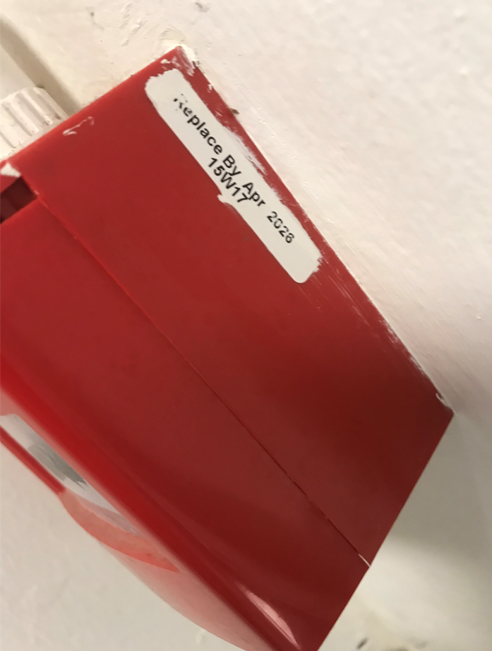

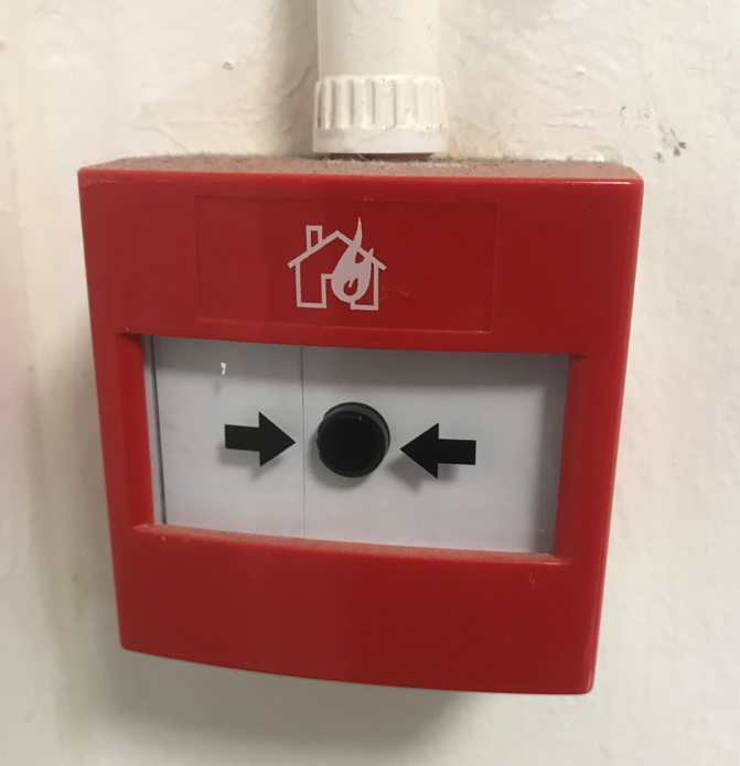

Here are some images of the call point:
I am questioning whether there is any benefit in having a key for this as it's just as easy to test the system from any of the detectors.
Interested in your thoughts on the above and also, what may have caused the issue which led to all the interconnects failing. Since I have not changed anything other than fitting the new heads, could the underlying issue still be there? Also, is there any reason to retain or fit the bases that came with the new detectors? I left the old bases apart from the one that had a burn mark.

On a system that size you really need a test switch - otherwise if there's an alarm, you'll be chasing round trying to find the one that's triggered, while being deafened by the racket. With the test switch, you can press the locate switch and all but the one that triggered will turn off.
