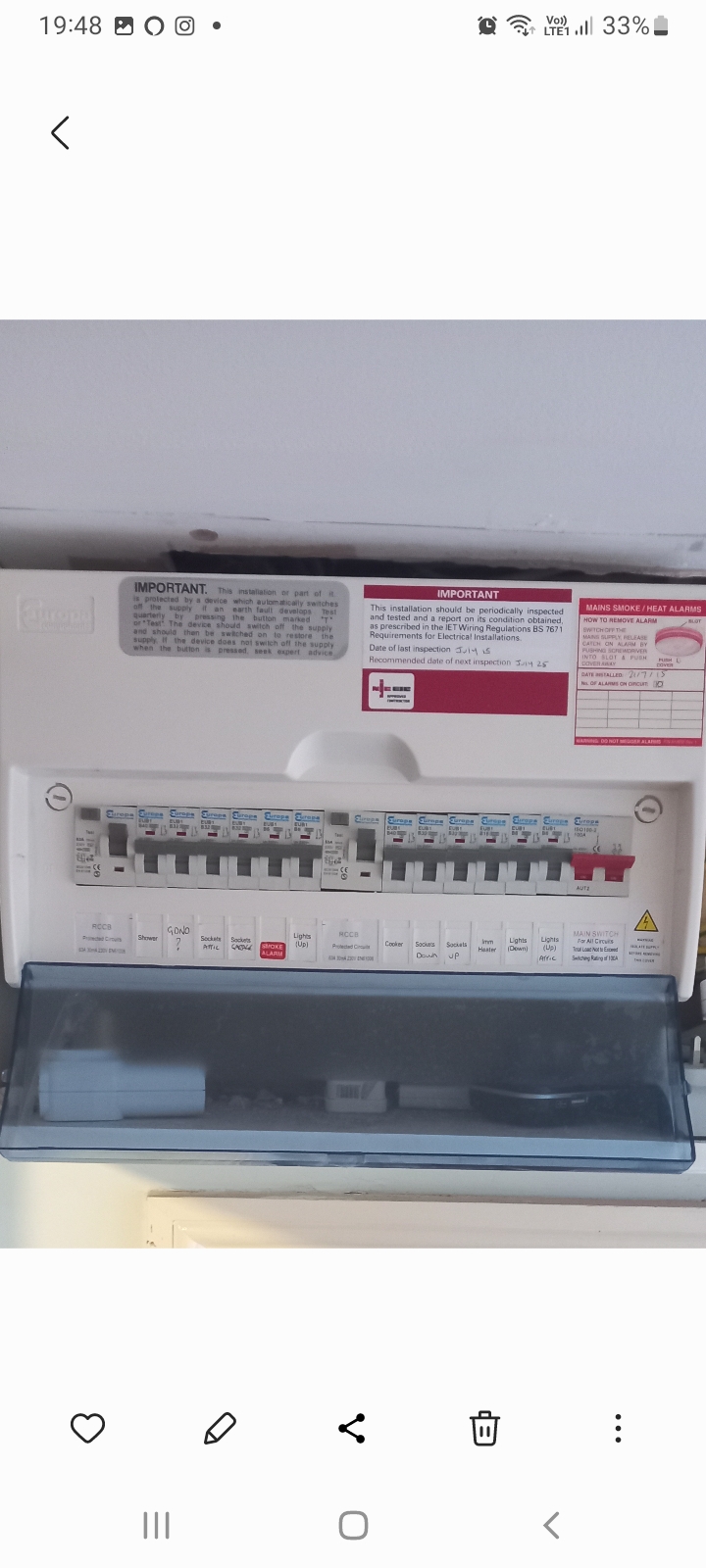

An electrician has recently quoted to replace our old oven. He says that the new oven has different power requirements and he needs to replace the consumer unit to make this lower and avoid burning out our new oven within weeks! The cu was new in 2015 so I am concerned that it now needs replacing - this will cost double the cost of the oven... Help please!

On the scant information you have given it is hard to say the truth of the matter. How many Kilowatts is your new oven and how many kilowatts is your old oven? If you dont know, give us the model number of the ovens. Does your old oven plug in? Does the new one, i.e. does it have a plug on it??? Can you photograph the board he is talking of changing and put it up here? Of course you could always just return the oven and get a lower rated one to match the one you are replacing???
Apparently the old oven was higher than the new Hotpoint DKD3 841 IX one. He said something about old being 40 and new only being 20. Both are hard wired but the position isn't changing. He said the new one would burn out due to the difference...images attached.

New oven is 4.7Kw. A 'standard' 6 sq mm cable and B32 cooker circuit would be fine. Subject to seeing pictures, it sounds like you should find a different electrician.

BS. The appliance draws power it's not pushed into it! Totally fraudulent to suggest what he is saying. If it's lower power fine just connect up the new oven. BTW. Its worth checking if he is a registered electrician and wether he has a CPS no. Find out and notify his competent persons scheme, NAPIT, NICEIC etc. Let them know what he is up to.

If the new oven is only 20A than the MAXIMUM it can draw is 20A.
It doesn't matter that the supply is suitable for up to 40A, the oven can only draw up to 20A .

Since the oven is known as a fixed load in electrical terms, the existing 40A supply can remain as is without the need to change it - merely connect the new oven. (Although if I had a suitable smaller MCB closer to 20A I would probably change it - but it isn't mandatory)
However, it may be the case that your existing installation doesn't have RCDs (although given the age it should) in which case it should be upgraded - for more than the oven!)

OK, it sounds like you have an oven circuit which is currently protected by a 40A MCB and the new oven probably requires a 20A supply, this is likely to be specified in the manufacturers instructions.
Connecting the new oven to the existing 40A supply will not cause it to burn out, this is just not possible.
It is possible that the electrician who has told you this simply doesn't understand the basic science of electricity and genuinely believes that what they are saying is true (this is true for a scary number of people trading as electricians these days) or else they are outright trying to scam you.
Whilst technically it is acceptable to connect the new oven to the existing supply as-is there may be advantages to changing the 40A circuit breaker to a 20A one, but this would not require the whole CU (fusebox) to be replaced! It would only require the one circuit breaker to be replaced, even if it is not RCD protected currently then a circuit breaker which incorporates RCD protection, called an RCBO, could be fitted.

He said it only had one rcd??
