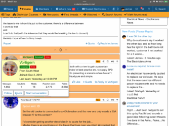

An electrician has recently quoted to replace our old oven. He says that the new oven has different power requirements and he needs to replace the consumer unit to make this lower and avoid burning out our new oven within weeks! The cu was new in 2015 so I am concerned that it now needs replacing - this will cost double the cost of the oven... Help please!

New oven is 4.7Kw. A 'standard' 6 sq mm cable and B32 cooker circuit would be fine. Subject to seeing pictures, it sounds like you should find a different electrician.
He said it only had one rcd??
There are 2 RCDs in that unit, they are the two devices labelled as RCCB.
Whilst I tried to give some benefit of the doubt earlier I would say this confirms you have been outright lied to.
I see no reason why that 40A MCB couldn't simply be swapped for a 20A MCB if that is required, those MCB's are current and still available.
There may be some mention of that CU being plastic when these days we are required to fit metal ones, but that would not prevent the work as you have described it from being carried out.

Nothing wrong with that consumer unit. (ish)
It has two RCDs!
He can't even count.
You could get the 40A MCB changed to a 20A or 25A, they are available if you want.
Now, it is the case that that consumer unit does not meet current standards, but in itself that doesn't mean it has to be changed.
If there is any sign of heat damage and/or a couple of other things, then it should be changed.
But from your photos, there is no evidence that a change is mandatory.
The rules have changed since your CU was installed. Yours is plastic, and only steel ones can be fitted in domestic properties now, but the rules aren't retrospective, so as long as individual parts are available for it (which they are) it doesn't need to be changed.
