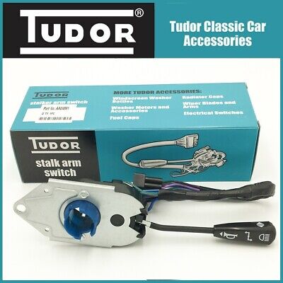

Hi, I'm building a kit car which has only indicators on the stalk so need to add a switch which operates main beam lights, but ideally also works as a flash (but without having to literally switch on and back off again). Does such a switch exist? Ideally it'd be a two way rocker switch with on/off one side and 'on' on the other side which rocks back, ie. for the flash part)

There is the option of changing the existing stalk for one that also has forward and back to operate the high beam. That used to be the way for many older cars. Then use the stalk to operate a relay for high beam as typically these stalks do not have the umph to operate the lights directly.

I just googled indicator stalk with high beam, above is using search function in Ebay.
Loads of options from classic cars

Have you a pic of the stalk you wish to use ? You may be able to modify one using a reed switch, for instance.
This one doesn't look too bad.
