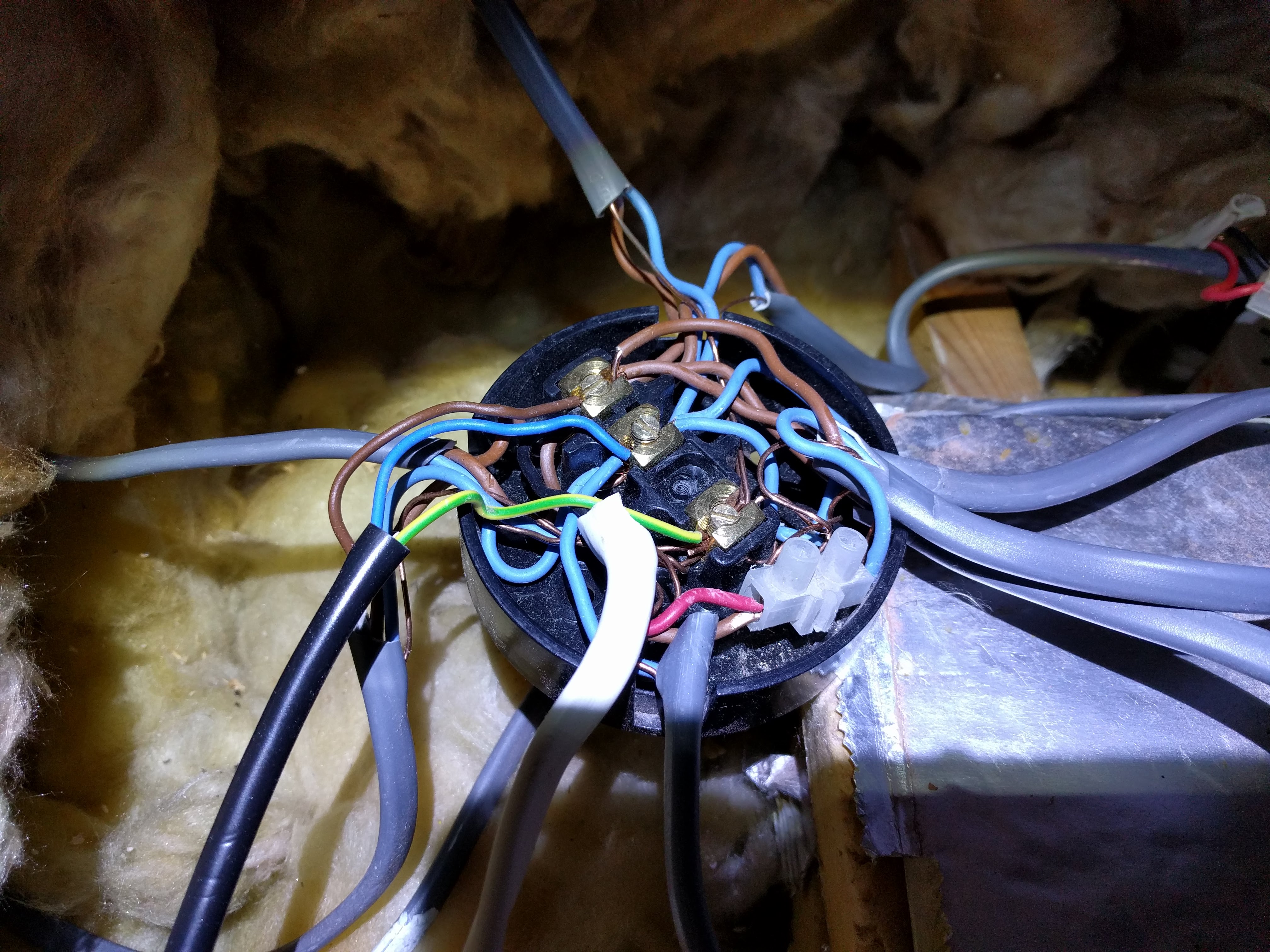

Quick Q from a newbie. I had a NICIEC registered electrician install an isolation switch and extractor fan in my downstairs bathroom. I’m now replacing one of the down lights and found what is a surprising mess of wires in the false ceiling, all joined together with a terminal block (centre is neutral, left and right are live).
The grey cable leads to the isolation switch and the terminal block has been installed by the electricians. They’ve twisted the earth wire onto an existing twisted arrangement.
Is this safe/correct? I found it surprising from an Australian perspective but am open to being told that this is how things are done in Britain.
If this isn’t right, what should I do before adding the downloght? Put the terminal block in a junction box? Solder then sleeve twisted earthing wires?

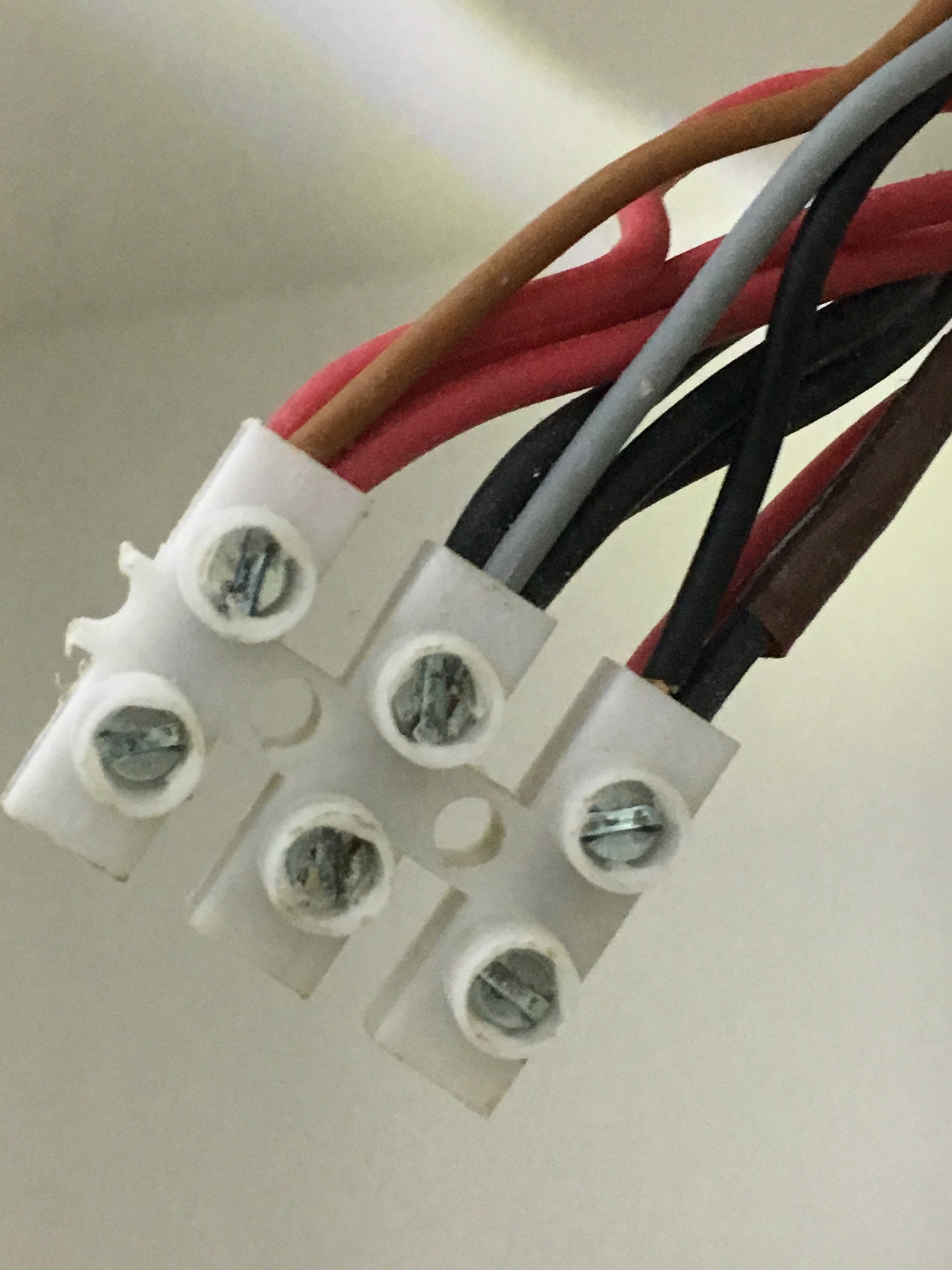

Chris, it’s a 7.5kw induction hob that can be wired into a two phase supply, the idea I think being that by having each half of the job on a different phase, it’s a bit nicer to the DNO. I only have a single phase meter, so it’s necessary to bridge the wiring in the terminal block
on the hob.
My wife pointed out to me that the left two burners were giving an error message. I lifted out the hob and checked the wiring and found only one of the phase inputs had been connected (the rightmost connectors in the terminal block).

Cant beat an inline fan thrown across the loft.
To many cables for that JB, sleeking missing off some cpcs , Cable sheath outside JB, inline fan slung on joists as mentioned never could that have been done by an Electrician, if it was, then he/she wants to give up and stack shelves in Tesco, an utterly appalling job, needs reporting to trading standards, Watchdog, the mind does indeed boggle, to not incur the wrath of the Mods I'm not going to say what I'm thinking.

Thanks all; I've asked the electrician to come back to rectify the issues I've found. He is a busy guy, and I suspect that what happened is that he was so busy that he got a newly qualified/apprentice to do the work, and didn't have time to check it himself. I've also found an additional issue - a 45 amp cooker circuit on a 16 amp type B MCB.
As you've suggested, I'm going to get an EICR done by an electrician qualified to do commercial fixed wire testing. I'm hoping this won't be too intrusive given carpets and floors are down, but safety has to come first.
