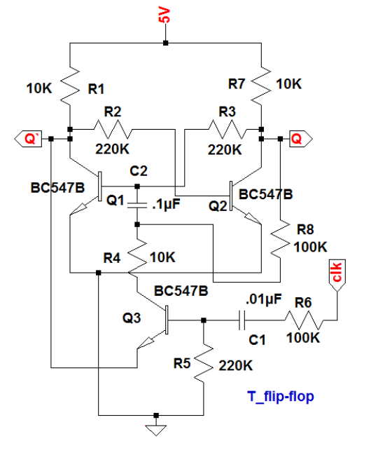

The simplest divider I can think of would need at least 3 transistors (without resorting to odd devices like the unijunction transistor), two for the state memory (i.e. flip-flop) and a 3rd to try and steer it to change state on each edge. Others seem to have the same idea as here is an example of a T-flop (scroll down the page):
But, as Lucian pointed out, they end up with RC time constants that limit the useful frequency range. The example on the link above would not operate anywhere close to 20MHz due to the high-ish R and stray capacitance, device capacitance, etc.

Mister @pc1966 and I were looking at this circuit for some time.
Flip-Flops Using Discrete Transistors:
I know it looks a bit full... I want you to try it at 100MHz and see if it can split it in half I guess, so its Q will be 50MHz. If it will do it, I will start making some of them. You are making it on breadboard, not definitive board on cardboard or fiberglass like I do it. It will really take you some minutes to check at what is the maximum fv can be used. It will be great if you have a fv variator of some kind... that will tell us the maximum range it can go.
I could make it myself but I have to make a couple of them, to really bring down the fv to my devices level that I have here. And I probably will, because it will most probably be too much for you. Will it?
