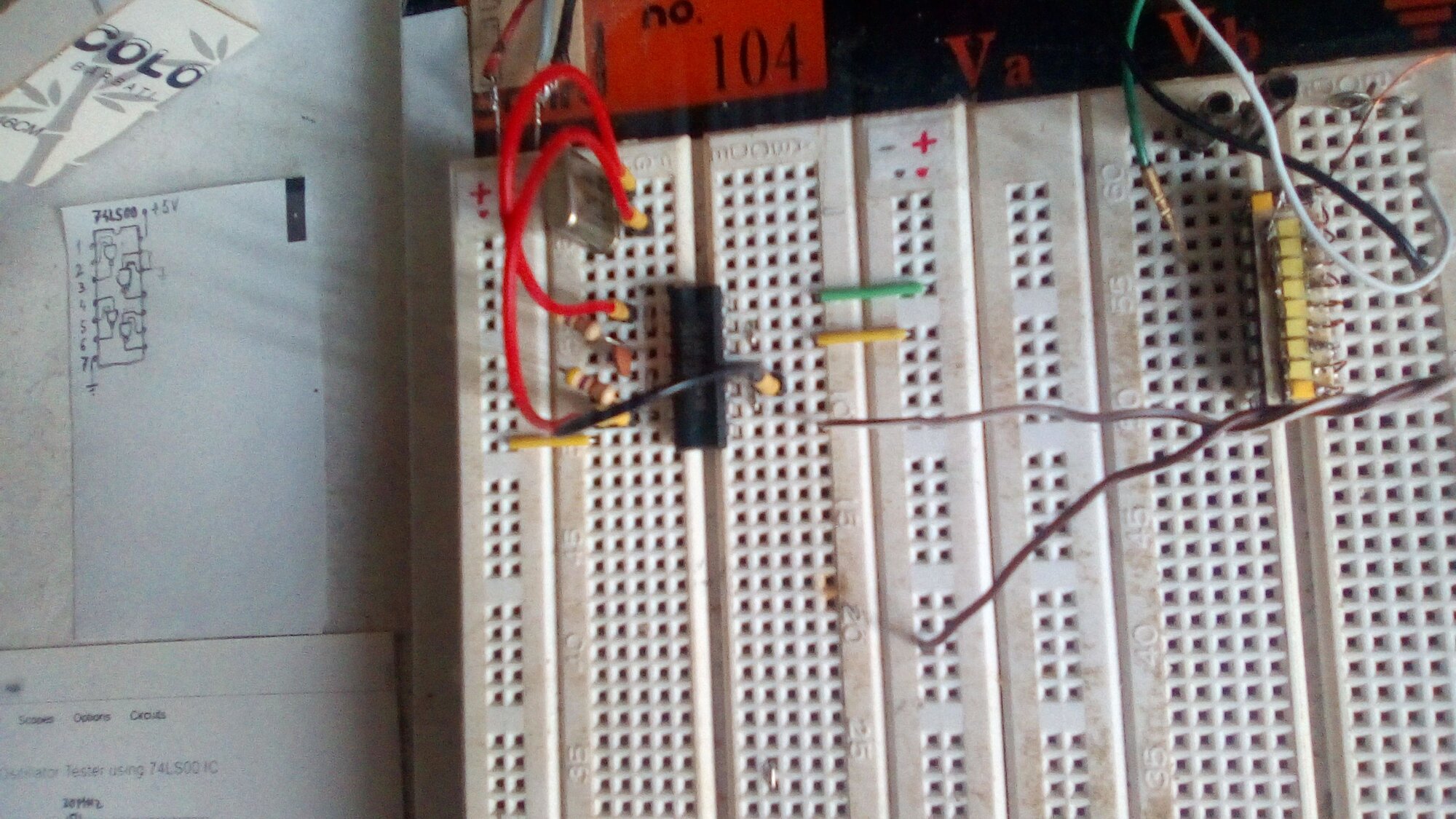

And I quickly built up this circuit:
[ElectriciansForums.net] Make a very simple test for me
and I got this result/reading:
I used the exact values in the circuit, 20MHz osc, 100pF cap and mister @marconi 's 74LS00 IC.

This morning I received mister @marconi package.
View attachment 98017 View attachment 98018 View attachment 98020
No decoupling capacitor!
While not always show at the IC on schematics, any fast logic design needs something like 10nF - 100nF ceramic capacitor close to the Vcc/Gnd pins of each IC or couple of ICs (maybe less if ground plane board used, etc).
You need them to keep the supply impedance down at the ~5ns switching speed of the device, that means short leads close to the IC. If you have some ceramic cap in the 10nF-100nF range (value not too critical), try straddling the IC from pins 7-14 of the oscillator and see if it changes behaviour.
