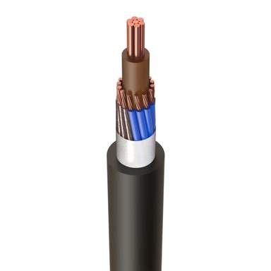

How long is the cable run in spilt concentric between house db and sunhouse db? I am wondering if there is a cable charging effect which may be tripping the 40A mcb due to voltage disturbances up stream within your house or even external to it. If this was the case there would not need to be anything connected and powered up for the 40A to trip from this cause. But it would be exacerbated by the current waveform of your IT power supply. And also items turning on and off in the home.

One would have to be very careful investigating because the split concentric is live even with the main switch off and it may be damaged and unsafe.
