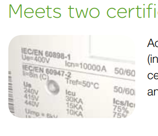

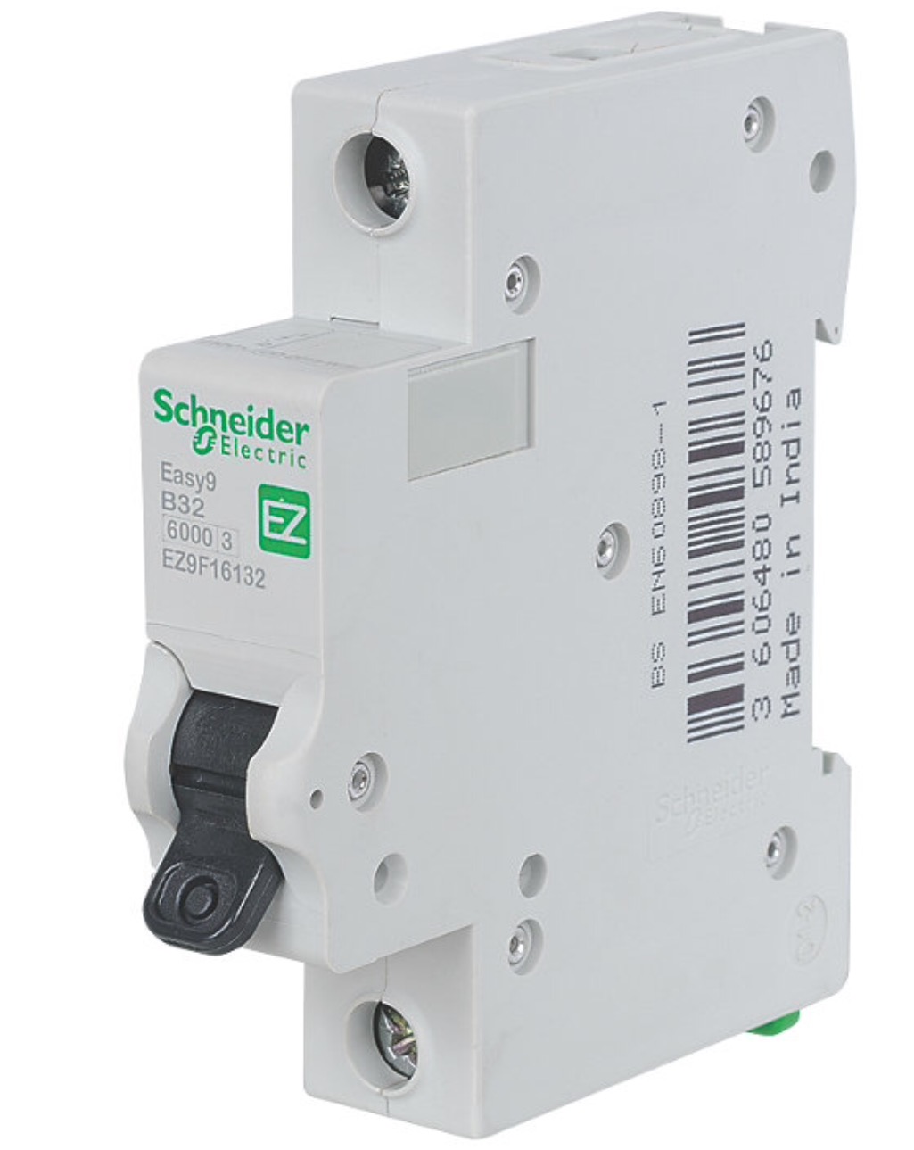

I realise this is just me being stupid but where do I find the breaking capacity (kA) on a schnieder bs en 60898 need to write them down on the test sheets
Thanks
You'll find them either on the front, or on the side, in a rectangular box. I think sometimes they are written on the side without the box. In a TP&N board you'll find they'll be either 10kVa or 16kVa (or at least mine where, I had a mix of newer and older ones when I did it).
Normally on the front of the MCB in the rectangular box, assuming IC60h range???
I'll be on the side like the picture below, you're looking for the Icn value.
Picture is taken from - https://download.schneider-electric...Acti9+Launch+Catalogue.pdf&p_Reference=SE7856
