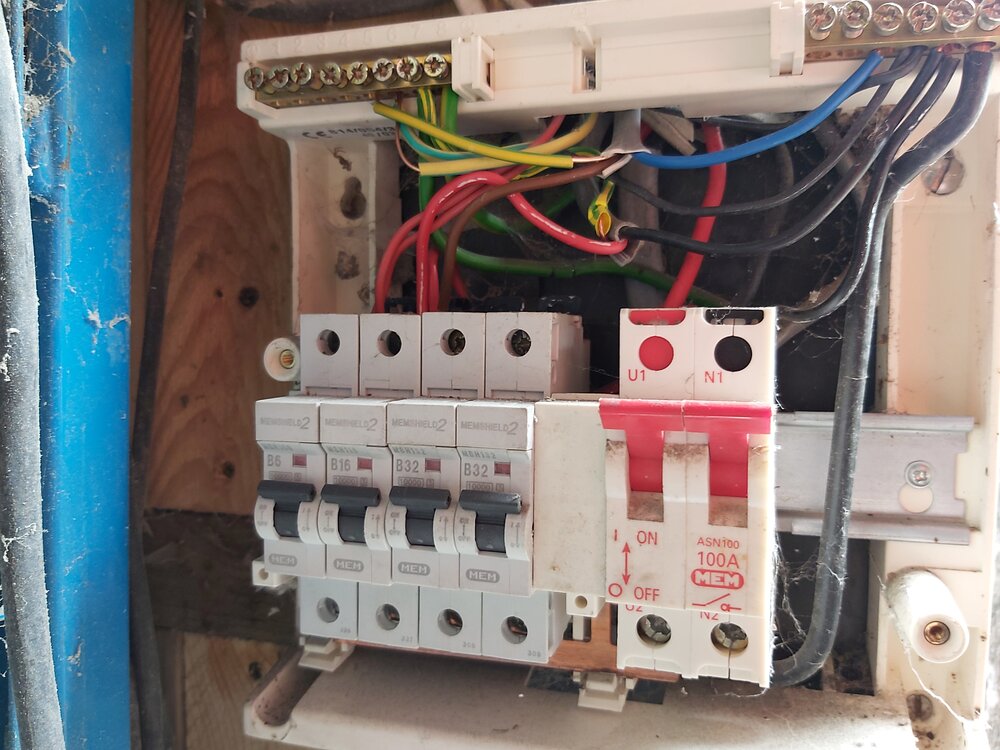

This is the workshop unit. And the 16amp is the sockets the two 32amp are unused and the 6amp does the lights.
  • [ElectriciansForums.net] Mitre saw tripping main breaker - Help!
Well the garage CU is obviously of the same era so that kind of makes sense.
But no RCD protection - not good.
Can you see how the SWA cable is terminated, has it got a proper gland? (brass thing, usually sheathed with rubber condom-like cover, grips the steel wires and usually has a brass ring tag "banjo" that earth is connected to)
I see 3 cables off the socket circuit, so it is not (all) a ring and that might be why they are on 16A and not 32A as 2.5m radials are not rated for above 20-25A depending on the thermal conditions.
Is there a ring of a few sockets and another odd socket added somewhere? Or is it 3 radial circuits?
