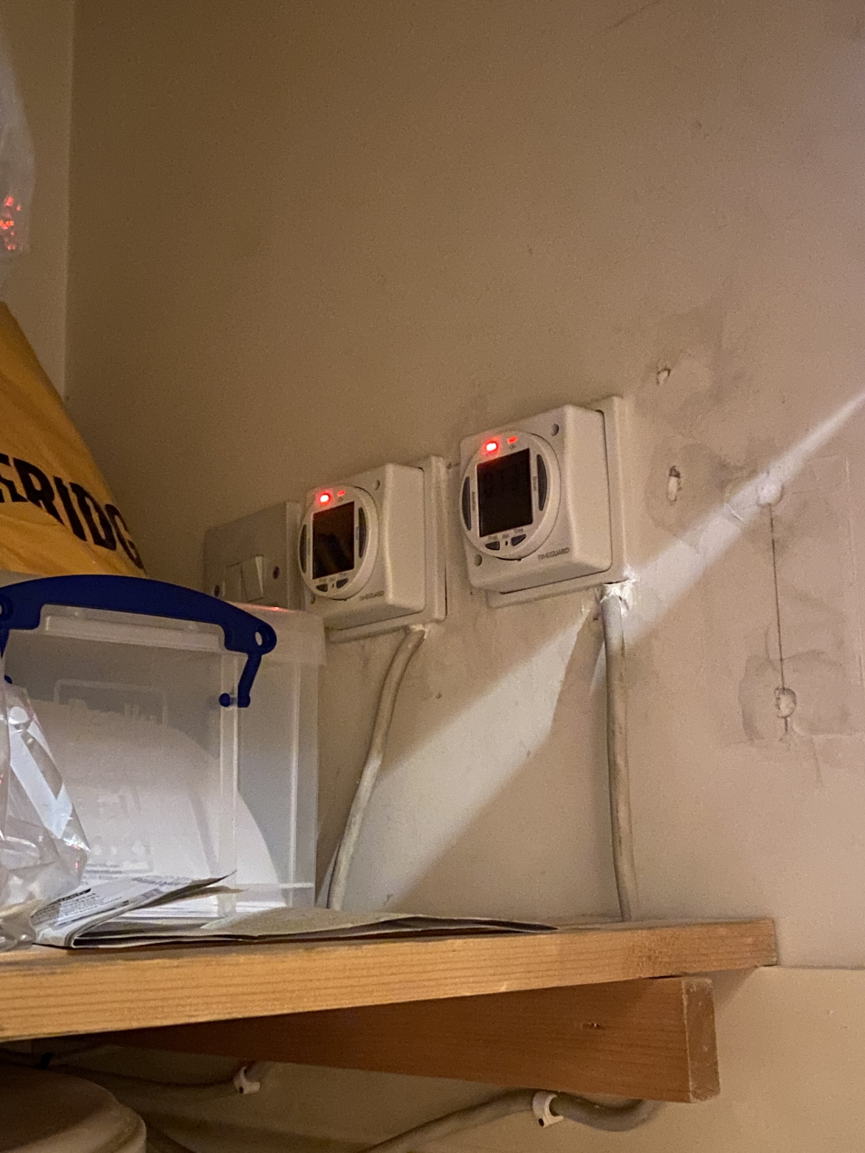

Yesterday I swapped my RTS meter (two rates-Economy 9) over to a Smart Meter as I want to be on a one rate tariff; my radiators are electric and I no longer have storage heaters; my only appliance that is currently on Economy 9 is my thermal store that heats my water. when the thermal store was installed I was on an economy 9 rate/tariff. I had two Timeguard timers installed that are connected to the thermal store; the timer on the left was my off-peak supply (till yesterday) and the red light was always on-indicating it had power supplied to it. That timer was connected to my lower (off peak) immersion, and right timer was for the boost on the 24/7 supply and that is connected to the top immersion.
When the electricity company meter guy came I explained that I want to keep my off-peak supply life but moved over to a 24/7 supply my electrician told me to tell him that I want both meter tails put on the 24/7 supply. He assured me that he done just that. however shortly after he left I went into the cupboard where the thermal store is I noticed that the red light on the left-hand timer was faded it was not on indicating that there was no power to that timer. The red light on the right hand timer (24/7 supply) was red-indicating that there was power coming into that timer.

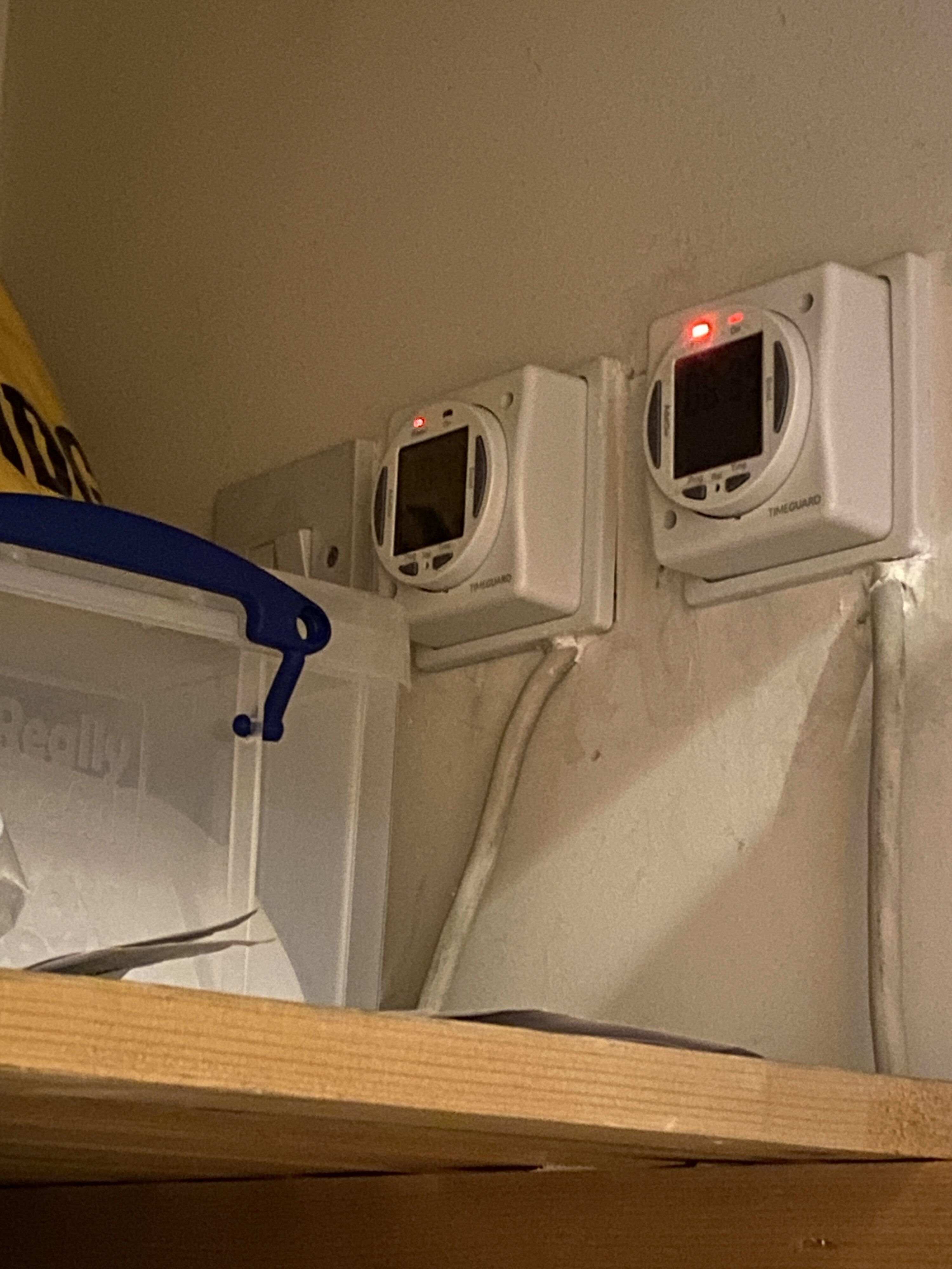

So as far as I'm aware yesterday there was no warming up of my water from the lower immersion-the old off-peak supply. However this morning when I woke up I checked the cupboard and lo and behold the red light on the left timer was on so I thought problems solved an hour later I went into the cupboard again and saw that this light was off again indicating no power to the left timer. although I have times left the immersion doesn't kick in at those times the water wasn't warming up yesterday during the times I've set the timer or two and it hasn't been warming up this morning at the times at the time was set to. I do not know what caused the red light to come on this morning but somehow it has gone off again.

My situation is this: I currently have two timers connected to my thermal store that heats my hot water. When I was on Economy 9, I had my Off Peak timer come on 2-3 times/day at the cheap rate times. I never had any need to use the Boost (top immersion-connected to the timer on the right).
Now that I'm on one rate/day-do I need two timers? I do want to retain the boost function, just in case I ever need to use it.
But I am confused as to why my left side timer (that was connected to my old/former Off Peak supply) is not getting Power (consistently) when it was supposed to be put on the 24/7 supply?
Is the timer that I have not compatible with a one rate/day tariff?
Photos are attached-one from last night when only the red light on the right timer was on, and then bizarrely, both red lights were on this morning-and not at a time that the timer was set to come on. And an hour later the red light on the left timer went off again.
If any of you have a clue as to what went wrong when my supply was moved from Economy 9 (two supplies) to one, please advise. I'm trying to get my electrician over on Monday.
