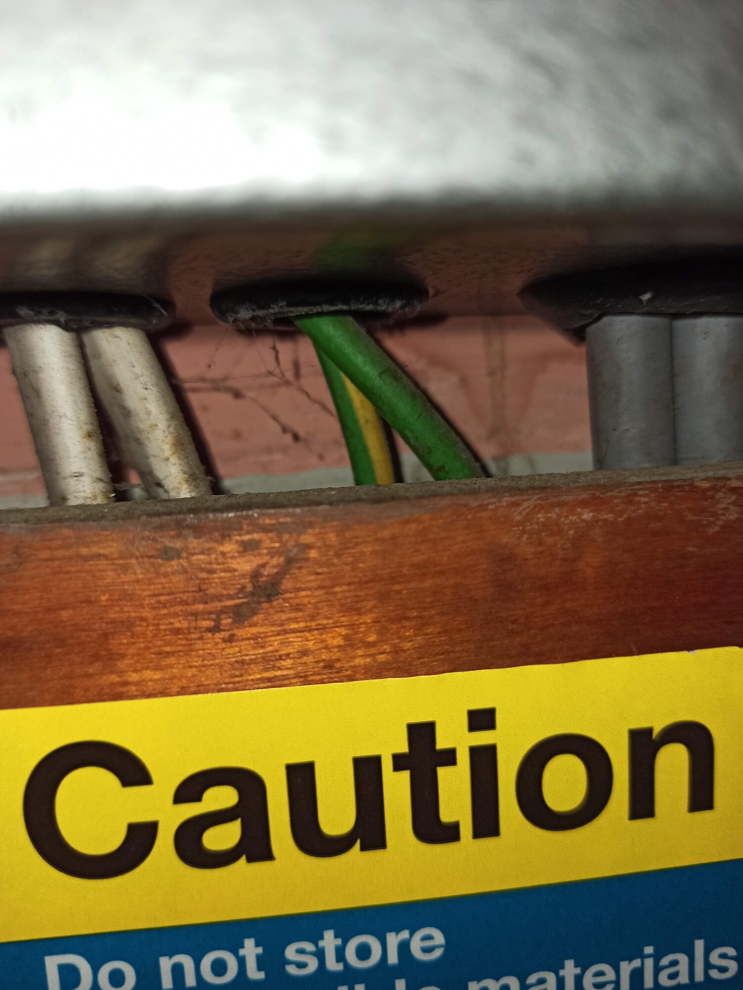

I will try to upload the pictures so you can see what I am talking about. I took two quotations. One just ask for pictures and quoted me for new BG CU with RCBOs, meter tails, upgrade the earth cable as the old one is only 6mm.
The second one visited my house today and after looking at the meter fuse board gave me two quotes, one including materials and one just his labour, testing and certificate charges. He said there is no need to tell Building control as he is registered and his certificate covered it. His quote includes fitting new CU and meter tails. But he said he won't change the earth cable as that is coming out of cut out and he isn't allowed to touch that. He also told me that the tails from the cutout to the meter and then to the fuse board are 16mm. The cutout fuse is rated 100A. The length of tails from cutout to meter is about 60cm and from meter to the fuse board is about 120cm including all the bends. Is all this acceptable? I know that I can ask him to fit 25mm tails to the CU but who is responsible to change the tails from cutout to the meter and who is supposed to change the earth cable for bonding from cut out to the gas pipe.
I have an appointment scheduled with British Gas to fit an isolator between the meter and fuse board as the first electrician asked for it. Can British Gas electrician change the tails and earth bonding cable from cutout while fitting the isolator?

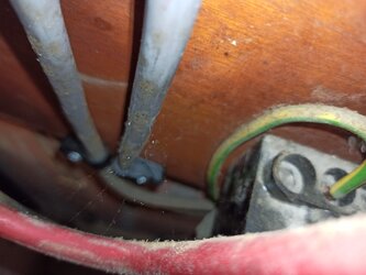

On closer inspection I found that earth cable is going into a small square size block moulded on the left side of cutout. This blocks cover is being held by a sealable screw. The "do not remove" seal isn't on this earth cable as I thought instead there is silver cable which come out of cutout, and goes underneath into this small block. The earth cable from top of this block goes to fuse box routed behind the ply board. Then another earth cable comes from fuse box for binding to gas pipe and continue on the gas pipe into kitchen under the floor, possibly to the water pipe and hidden out of site. I believe I should be able to unscrew this cover to have a closer look. Could it be the earthing terminal inside this block?
Just found this link in UK power network's site. Can I ask them to inspect the earth cable by requesting a visit or is it unnecessary. I don't know if they will charge a fee if they do any work but the visit and assessment is free.

The sealable screw isn't sealed on this earth terminal block or whatever it is called. I unscrewed the cover and took a picture. It seems that any electrician should be able to change the earth cable as the green yellow cable is just connected to the too of this block. The DNO's earth connection with do not remove seal goes to the bottom of this terminal block and doesn't need to be touched. I personally feel it is dead easy for any electrician to upgrade the earth cable here unless there are some caveats to it.
