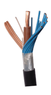

The neutral and cpc are not combined in the service head and are separate split like the picture
Thanks for the picture - that looks very much like the configuration in the image I originally posted. Just to clarify is the consensus still that this is TN-S?
This would align with the observation that the PEFC and PSSC are different.
Thanks again for very helpful insights from the forum.
