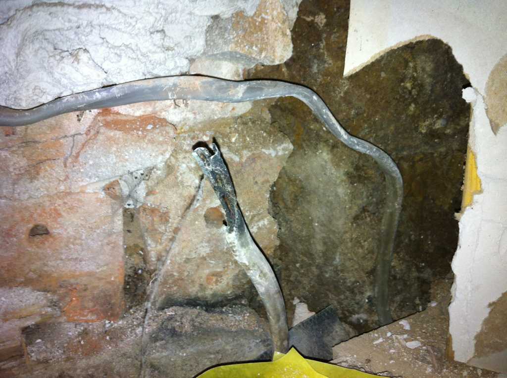

I had a customer with the same problem just a few months ago. A hell of pop!
Found it behind the skirting - chewed by a rat!

One time it was rat damage behind kitchen units and the second was from some crap work by someone else who had clipped the insulation of the cable when clipping to the wall.
On both occasions, the presence of damp made it worse.

i had a similar thing when i first moved in my house,same type of noise coming from bedroom wall,drove me mad,it always happend when it was a bit breezy,turns out the cable for wall light switch had been fed down cavity wall and when the wind picked up the draught in the cavity would cause the cable to swing and knock against the plaster board inside the cavity,ended up just pulling it out and ditching the wall lights,didnt like them any way.
