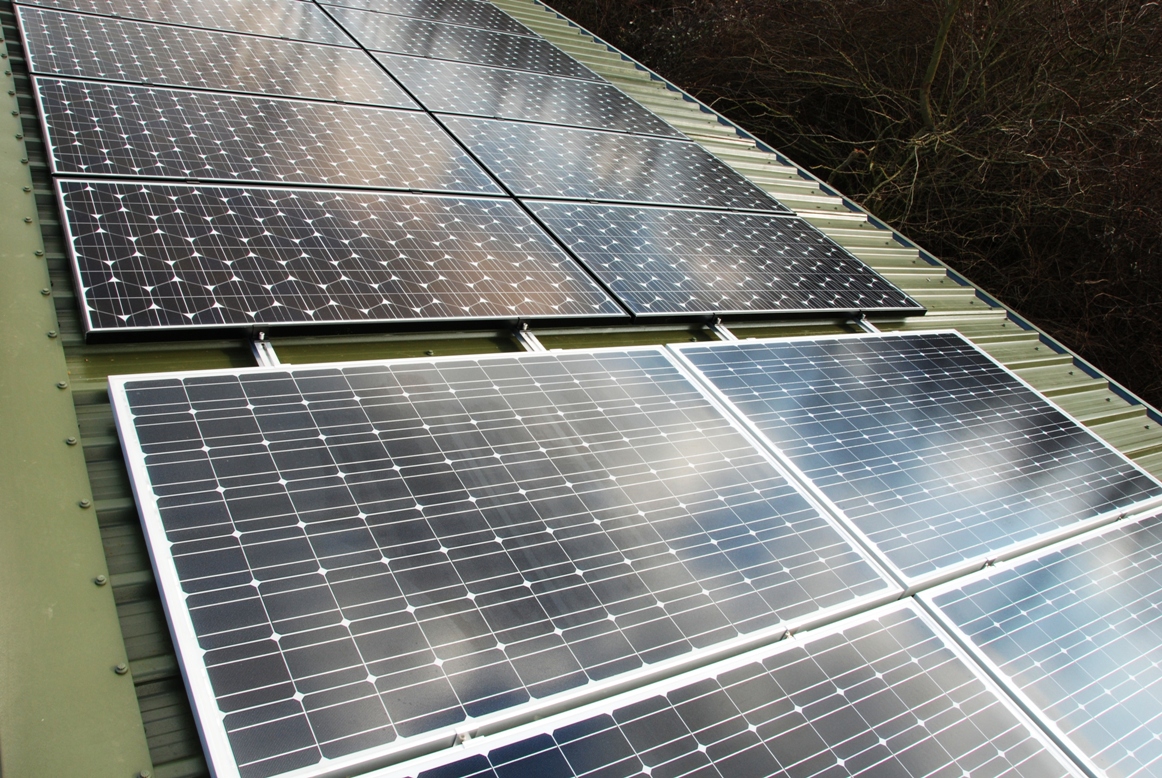

Having been confused and irritated by the conflicting stories I heard about the relative merits of ‘expensive’ versus ‘cheap’ PV panels, I decided to find out the truth for myself.
I have just fitted an 8kW installation on my shed roof, comprising one 4kW array of 16 x £177 Hengji Solar HJM250M-3232 panels, and one 4kW array of 16 x £343 Sanyo HIT-H250-E1 panels.
These are run via two totally separate, but identical, electrical systems, from a 4-core 10mm SWA DC line into two single-phase Diehl AKO Platinum 3800S inverters, feeding into the two AC phases via two Landis & Gyr PV30-108 generation meters, mounted side-by-side for easy comparison.
These two arrays, mounted side-by-side on the same South-facing roof, will give an ideal and un-arguable comparison. No sales BS, no hearsay and guesswork, just clear meter readings.
I was trained as a scientist. I perceive the world through scientific eyes. And I like experiments. Game on!
It will take a year to give an accurate answer, since the characteristics of both makes may result in one out-performing the other under certain seasonal conditions. Day length, temperature, light intensity variations, and so on.
This will be most interesting. I will contact the media, and both manufacturers in due course.

The idea of a comparative test only occurred to me at the last moment, after 16 of the planned 32 HJ's had already been installed. I immediately flogged the remaining 16 HJ’s on EBay, and ordered 16 Sanyos instead :)
Had it been planned from scratch, I’d have alternated HJs and Sanyos on the roof, and extended the wiring looms between alternate panels. But I think side-by-side complete arrays is good enough. Any slight difference in solar exposure due to position should not be statistically significant.

I notice that there seems to be some shading in the photos, how where you thinking of creating fair test conditions? cut down the trees or swap the panels from one side to the other after a year? even the early morning late evening shadows could affect the results significantly!

Q/ Why do people put expensive solar pv panels in poor locations, surrounded by trees with lots of shade potential?
A/ They act before they think.
To add insult to injury, they then install them with inverters not preferentially designed to work well in shady conditions.
You can install solar pv panels with world beating technology, but if you dont choose your installation location wisely you are wasting your time.
Such comparitive tests between 2 different solar panels are best done in installation locations with minimal shading issues to get a fairer test result.
Your photo's clearly show that you've got shading issues.
When the trees gain leaves in spring, it'll get worse.
People should think carefully where they intend to install solar panels, before putting them in, else they will be buying an investment that will underperform its optimum.
If shading is an issue, I would have installed the panels on Solar Edge Inverters, with 1 microinverter per panel.
Good question. There is young woodland South of the shed. I intend to pollard the trees that are close to the building this week, and keep the tops of the trees below the gutterline.
The tree density is equal on East and West so I expect both sides of the total array will be equally disadvantaged, as you say, in early morning and late evening.
It's good that there is a little shading, since performance under partially shaded conditions is an important design characteristic of PV panels, so should be included in the test.
Solar Panels love shade as much as a blind man loves not seeing the light.
To add insult to injury, they then install them with inverters not preferentially designed to work well in shady conditions. …
Really?
Well, a salesman told me that when you have potentially shaded conditions, you MUST buy the most expensive panels because they are designed to deal with the shade.
But I don’t care.
Because this is a real-world test, based on a real install, not a lot of unsubstantiated hearsay, or pushing of suppliers’ preferred systems.
Shaded or unshaded? Sahara desert or Norfolk? North or South or East or West? So what?
Here are two sets of massively-differently priced panels in a real location side-by-side. I’m not sure it’s been done before. Why not?
I’m expecting the ‘losing’ panel’s supporters to come up with all kinds or ‘Ah buts…’
eg ‘This is slightly shaded but ‘my’ panel would have been so much better in full sun.’ or vice-versa. Sorry, it’s all BS.
If anyone disagrees I suggest you also try an experiment so we can compare.
What’s the expression? Put your money where your mouth is?
