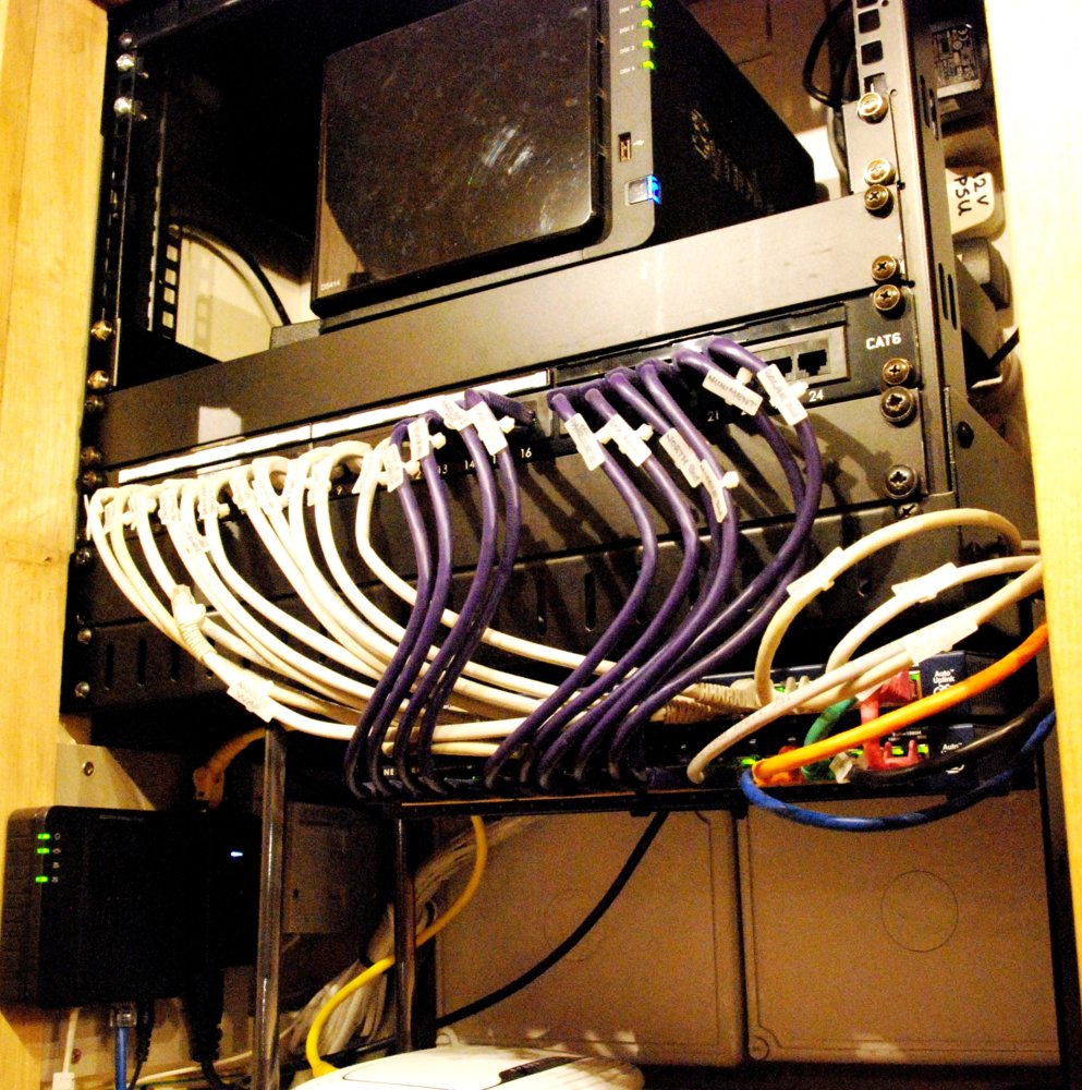

I know nothing about the Tv stuff but LAN points I did in my own house a few years back. As Freddo says, run a UTP LAN cable (? CAT 6) from each RJ45 jack back to a IDC patch panel in the cupboard. This can be a rack-mounted item on either a simple open frame, or a short 17" rack (EBay is your friend!)
That way the structured wiring is finished and terminated before you even have to think about what switch/hubs etc to install. If you have loads of RJ45s all over the house, you don't of course need to buy a huge switch with enough ports for all of them at the same time. Simply swap the patch cables about as needs change.
And don't, as I did, forget to put some RJ45 jacks up at ceiling level - perhaps behind curtain rails etc - so you can add wireless access points, IP cameras etc without needing to run patch leads up walls. Especially if you have a PoE switch, adding kit later is dead easy.
Below is what I did, quite a few years ago now.
Good luck!
