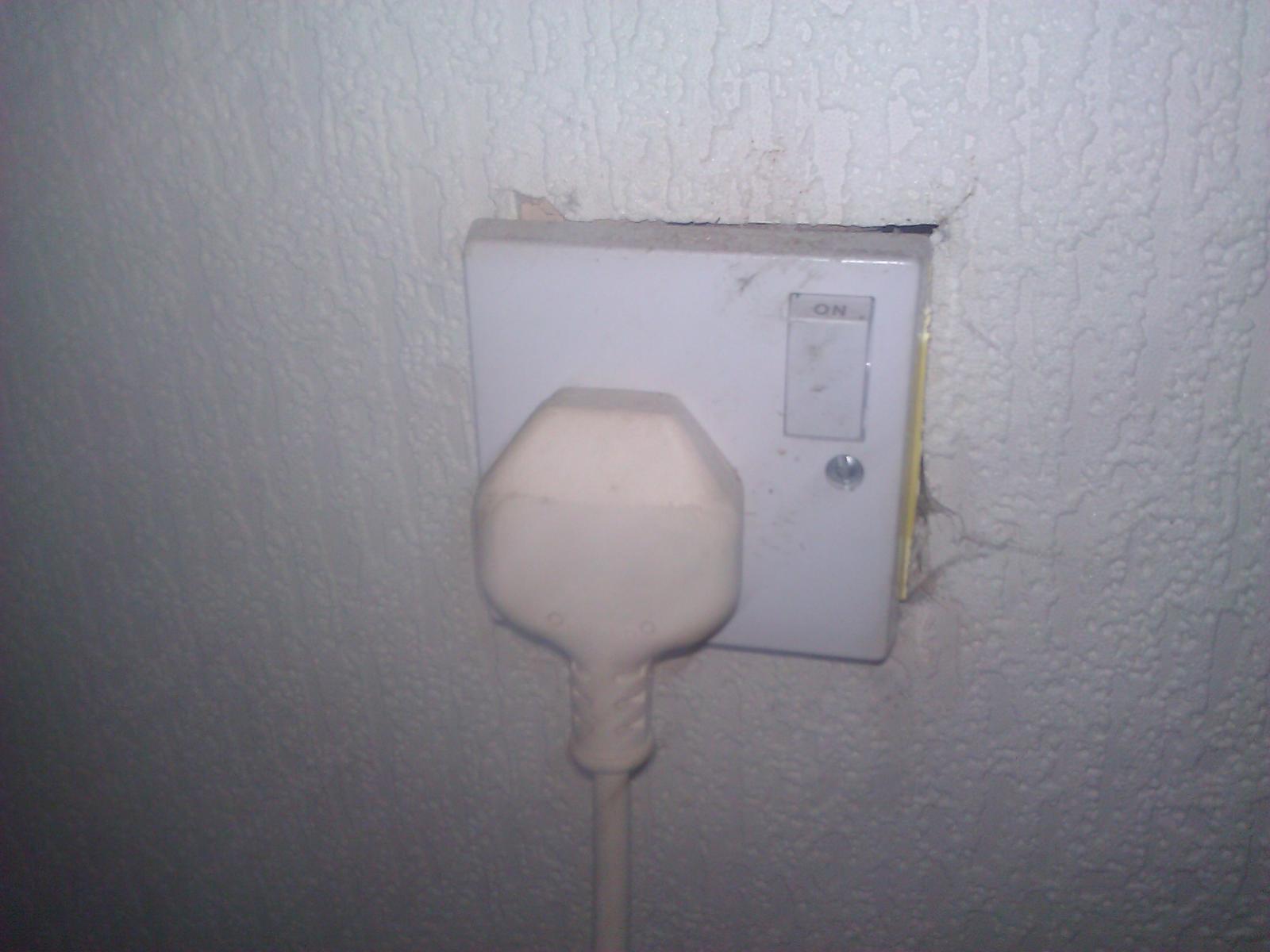

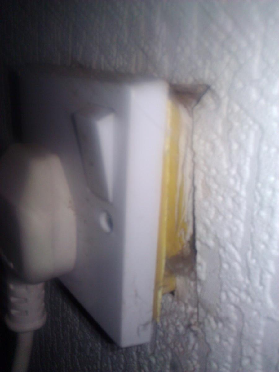

These are the safety boxs that they used. The director of the firm I worked for invented these. We called them "Uzi box's"
Putting these on made it easy and safe for the plasterer, tiler and decorater. The rewire team would do IR, Zs, Ze etc to make sure it was ok but not the paper work, then after the tiler, plasterer and decorater had been (2 weeks later) I would go in and I & T, fill in the EIC and remove the "Uzi box's" which was a pain in the arse because all the screws had to be cut down. Now I know your all gonna jump an my back because it should have been I & T before being put into service but this was the way it was done and neither the council or niceic or anyone else had a prob with it and being new to testing at the time, I didnt know different. They said if we tested it and did the EIC straight away, the plaserer or tiler etc could damage the cable/accessorie and it would have to be repaird and tested again any way. I must of tested over 300 of these council rewires over the years.
