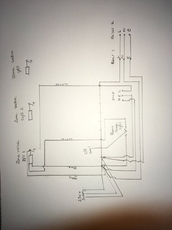

If it’s a secondary return it should be obvious as it will be plumbed into the cylinder secondary return...The pump will have bronze or SS impellers and the housing is usually yellow if it’s a grundfos pump.
Hi,surely you mean in parallel,with isolation? In series,would give the return/flow sensors,something to think about...
Two boilers in series. If there’s a Fault with one they still have heating and hot water. They have fitted a low loss header to the system aswell
You didn't think to.mention the low loss header at the start of the thread then?

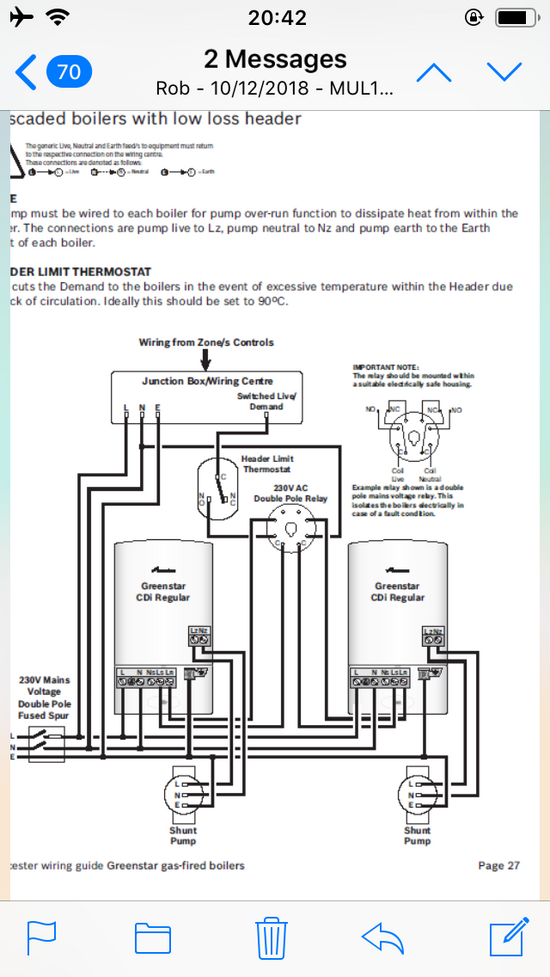

Based on this new information you will almost certainly have a boiler circulating pump which will need to be controlled by both boilers via a relay. This pump circulates water from the boilers into the low loss header.
The second pump will be circulating water from the low loss header and around the CH and DHW zones.
Worcester bosch will send you a wiring diagram of how to connect two of their boilers together if you give their tech support a call. It is important that you do this bit correctly otherwise you may damage the boilers or create a dangerous situation for anyone working on them in the future.
Have a look at boiler sequencers
....I have done...many,many times:)
This is why i know they are paralleled and not in series.
I did a two line post,hoping to get more detail,and Dave blew us out of the water with his thorough retort:)
These are systems and features,which are not added "ad-hoc",most generally specced and designed from the get-go. If this is the case,there will be system drawings for both the hydraulic and electrics.
If not,Dave's last paragraph is applicable.
