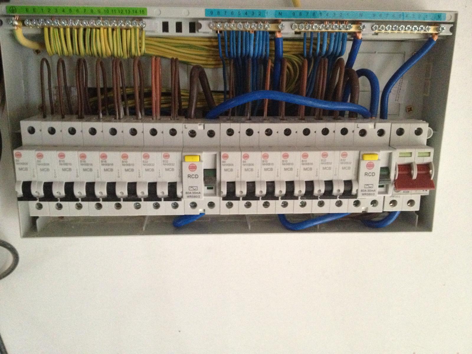

[ElectriciansForums.net] **Show Us Your Installs!!!** Almost finished, just left to terminate the swa. No trunking this time:)
The only thing that i can see worth mentioning is to get ferrule crimps in those fine multi stranded neutrals going into the neutral bars....
Just as a point of interest the last Wylex board I fitted had neutrals like this; but they appear to be 'glued' for want of a better word; the ends are somehow fixed into a rigid pre-formed rectangular profile so they form their own profile, not sure how it's done but would welcome someone enlightening me.
I think it is the same with most of domestic CUs, hager, proteus is the same. They come from the factory that way, even if you take them out, they are not getting lose.
No idea i've only seen factory fitted crimped type ends. So what do you do when you cut these neutral tails to size, to suit the CU install?? If nothing else at least fitting an insulated ferrule crimp connector will do away with seeing bare conductor entering the neutral bus bars!!
Not very pleasing on the eye and a bit lacking insulation wise but that's the way they come from the manufacturer. The strands are fused ... soldered in some way to make a solid.
They come in position, in made up lengths, to suit the whichever unit you buy, flexibility being the important point.
The line connectors on the 7th breaker from the left are a different shade of brown. Looks a right mess. Daz
