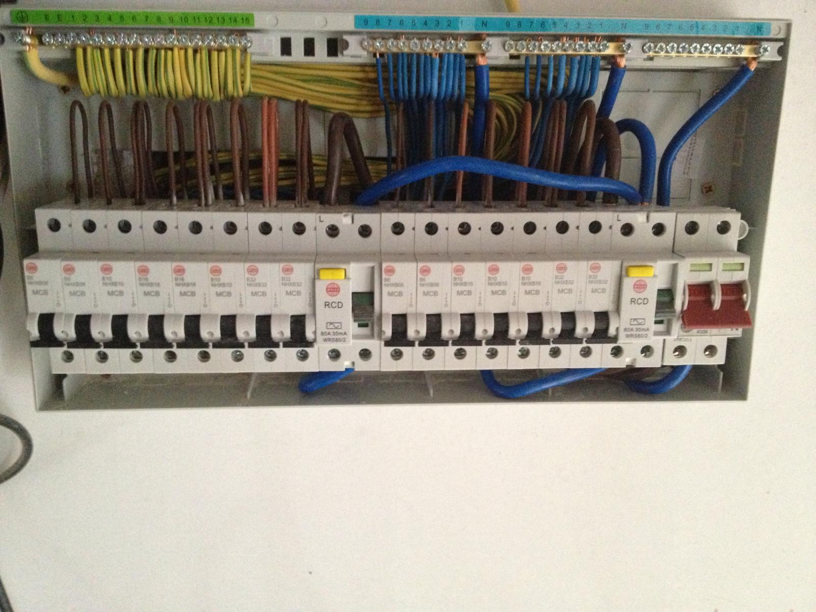

Looks very good, I have never managed to get a board looking like that, just never happens. As much as I try, there's no way it's going to happen. I think it makes a huge difference to how neat it is depending on if the cables enter from the top, middle or bottom. I tend to use MK boards and neR from the top, so never have much free space.
Bootlace or the flat spade like variety, they are both crimped connectors. I just don't like seeing 10mm or more of bare conductor entering neutral bars, or the MCB's come to that!! From what i can see of the OP's CU installation, as neat as it is, those RCD tails could do with a bit of trimming down lengthwise...
As I indicated previously, they come in made up lengths, in position, and aren't meant to be trimmed down. They may look untidy but the idea is to have the flexibility and loose any excess length behind the main body of breakers. I've done my share of industrial panel building and installation and these wouldn't get a look in....but they are designed for ease of installation in a domestic situation, much the same as most items, these days.
I agree, I don't like to see bare bare conductors in any environment, its not just about the looks. Whatever the reason - just wondered what your thoughts were on tidying those ends....
I've trimmed them down in the past but to be honest, its a multistrand cable with very fine strands and is an absolute pig to get into the terminals once the original finish is gone without any of the strands ending up outside the terminal.
Nice and neat my OCD approves :), though the 10amp on circuit 10 before the 16amp breakers would drive me nuts lol did you run out of breakers ;) or was the load less than you thought, it looks like a 6mm going into it or it's my eyes :).
Well spoted mate,it's 4mm and I didn't have a 20a breaker, that 10a is just so that I could finish it neatly and take a photo:)
I found it to be the same, routing cables from the bottom or middle into CU.
It is a good couple meters of earthing but not as much as it looks.
That's why terminal crimping this type of cable is a must as far as i'm concerned...
A little of bare neutral conductor in CU wouldn't make any other difference rather ten the looks. Before taking the cover it should be isolated and you can touch whole neutral bar anyway. I don't like the look of it but I tend to leave because of the manufacturer. I have seen one proteus CU with melted plastic around the neutral, it was due to CU couldn't hold the load that they specified. The neutral cable link was in 10mm and was getting too hot. I'm pretty sure if you would have trimmed the cable, they would say: oh it's your fault, that happened because you trimmed the cable.
It's called having pride in the work you perform, which you have proved to have. Typically if it looks pit's, then it generally is pit's...
Ehhh, ....Are you being serious here??
Nice neat and well presented y only comment if any is you have no room for expansion which should be factored into any design.
Thanks, the reason was that company is saving money and wouldn't spend any extra on like getting a 16 way or 17 way board, however I could squeeze some lights into one msb, but because it's a flat , and there's feeds for future underfloor heating etc, I couldn't think of anything else you would come up installing in it that would require a separate msb.
Not quite, if the accident would happen obviously it would be proven by investigation that it's has been manufactured wrong, but I would imagine if you would try to get your money back in the shop, saying it's getting to hot, they would try to blame it on you, on interfering with manufacturer. Although it probably depends on the people. I had spent half hour in the shop trying to prove that the rope light doesn't work because they have cut it in the wrong place :)
