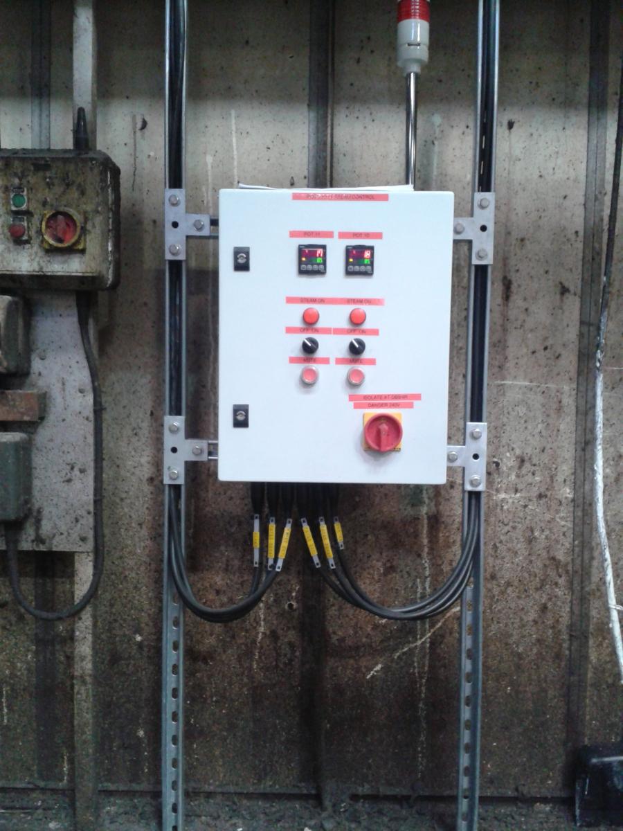

Yes in ducting all selv. What's the problem with that?
What about the ones marked up 230v ???
Can i ask why you chose SY ... its often misused and incorrectly installed and over the last 5yrs ive ripped out so much of this crap.. its design as a control cable the braid is a screening and is not mechanical protection, the outer clear sheath is unsuitable for outdoor use and whenever its is utilised as a power cable for LV the braiding should be earthed but a must is that it isn't used for earth.... not saying you have done any of this but interested to why this cable was chosen as i cant see any benefits with using it?
The 230v is for a commando socket below. Sy was chosen because the control side requires a screened cable with multi cores that is flexible enough to connect to the lights. sy seemed the best choice. All cables are glanded correctly with the braiding and no just using stuffing glands. What makes sy cable unsuitable for outdoor use.?

If the SY is not 100% shielded from the sun then you should look towards another cable with UV protection attributes ..the outer sheath is so designed on purpose mainly for machine use and similar control needs as it is see through and any degradation of the shielding/braid can be easily inspected.
Because the sheath is clear it lacks a lot of attributes found in most cable sheaths and even the ones it gives like moderate acid and oil resistance only apply at room temp' and can't be guaranteed when subject it to temp extremes... How its use has been catapulted into this fits all solution when it is clearly unsuitable for most purposes the average Joe spark utilises it for...
Pop onto RS Components web site and you'll find many better suited to your needs that don't have the limitations SY does although RS's downfall is it doesn't cut to length so Scatts maybe a better option .. the problem is most general wholesalers don't stock any other shielded cables so i assume this is a reason for its explosion into the scene of misuse as SY was promoted as a suits all cable with added mechanical protection ...a lot of uses took this as a open door for blindly misusing it.
The problem with screened cable is the expense of suitable glands but as SY has flooded the market it has seen a budget gland enter the market that is affordable.... if you venture for more suitable alternative expect the reality check of expensive glands to enter the arena again.

heres a couple of my last jobs.first one is a new switch room upgrade which im still on with. then a control panel controlling the temperature on two mixing vessels using PT100 probes
samsung phone 172.jpgsamsung phone 173.jpgsamsung phone 176.jpgsamsung phone 177.jpg
Is that standard to use unistrut as a cable containment system?? ...photo's #3 + #4
Are they unprotected/uncontained singles going in to that emg beacon?? ...photo #4
