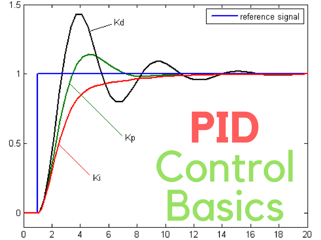

Please don't ignore the PID tuning advice.
You need to find out if the longer heating time is due to the controller "slowing down" the heating as set temp approaches.
or it may be that it's just the time it takes because of the thermal mass of the oven and the power of the heating element.
The controller has to be set to balance power "= speed of heating" vs overshoot. If you don't want to exceed 800 deg, it will take longer to heat the oven than if it doesn't matter about overshoot. See illustration below. Have you looked into these settings?
There's plenty on the web about this if you haven't investigated it already.
Here is a youtube clip which explains how to set up the controller initially and then to select auto tune (AT) to optimise how the oven heats up and then regulates its temperature. It is the same controller as the one you have although it has a different name.
Here is leaflet on your controller but I recommend you use the YouTube clip first.
