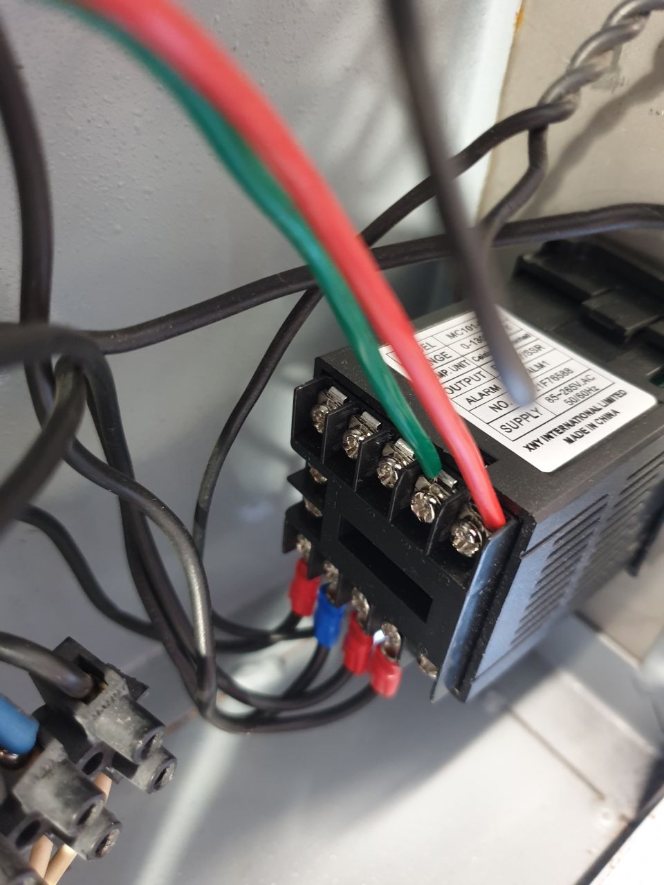

Hello everyone,
I have a goldsmith oven to which I had to change an SSR relay because when it reached 475 degrees centigrade the temperature increase stopped. Since the oven must reach 800 degrees in about two hours, I have to solve the problem.
I changed all the main components to the oven: thermoregulator, thermocouple, resistance. The problem of increasing the temperature was present even before changing all these components.
I ordered an SSR relay of the same brand and model as the one mounted on the oven: Crydom D2425.
Since it was panel mounted I proceeded to modify the panel to put a heatsink in it.
Between the heatsink and the relay I put some Thermalright TFX thermal paste which has a high thermal conductivity power and is also used in computers and can withstand up to 300 degrees.
After having reassembled everything I turned on the oven, this time it reached 100 degrees centigrade after 10-15 minutes the increase in temperature stopped.
I wonder where he went wrong about the SSR relay changing as I think I've done everything possible. Could anyone help me? Thank you in advance for your reply.
I attach some photos to the message.

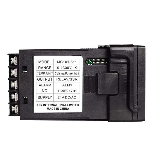

The input signal is set to the type K thermocouple, which is the one actually present and which has been replaced. The variable "d" corresponding to the derivation time is set with the default value "30", in the manual it is written that if it were set to "0" the derivation would be closed. The variable AL1, on the other hand, is set to the default value "10". The AL2 variable is not present. SLL (setting of minimum set value) and SLH (setting of maximum set value) are the variables that, if set, put a minimum and maximum limit on the temperature that can be manually set on the thermoregulator display, I wonder: what is the difference between these variables and AL1? I never understood what AL1 was really for, is it perhaps an audible alarm that sounds when the temperature is reached?
I am wondering now whether your controller is not exactly the same as the one shown in the youtube clip but similar in many respects.

Some variables in the manual are not present in the menu of my temperature controller. I list below the variables related to the PID that are present in the menu:
At, Al1, SC, P, I, d, t, rSt, LCy are present.
The variable 'At' is still set to Yes since I have activated auto tuning.
The variable 'P' is set to 20.0 instead of 30.0 as it would be by default.
All other variables are set with factory default values. You can see these values in the central 'Factory Defaults' column of the manual.
Al2, oH, rE, bUFF are not present.
English is not my primary language. I really appreciate your interest and thank you for your help.

Tried skipping through quickly so sorry if already mentioned, the colour coding on your thermocouple wires could be from a different global zone thus identified incorrectly, assuming the controller has been configured for the therm' type it is monitoring, not doing so will give the wrong feedback voltages and the wrong temperatures. Type K And J are commonly used but must be correctly input into the PID controller fir it to Interpret what the thermocouple resistance feeds back is.
Thermocouple Cable Colour Codes and Tolerances - TC Ltd - https://www.tc.co.uk/thermocouple-information/thermocouple-colour-code.html
The k type thermocouple has red and green wires which would indicate it is using the German colour code red for plus and green for minus. This is how it is connected to the controller. See #49.
mdkmdk - could you send me details of the thermocouple please? Is it made in Germany. Do the red and green wires go all the way to the thermocouple or have you joined the thermocouple wires to the red and green wires which go to the controller?
If you have a small permanent magnet and hold it near the red wire and then the green wire the wire which is most magnetic is the negative lead.

Tried skipping through quickly so sorry if already mentioned, the colour coding on your thermocouple wires could be from a different global zone thus identified incorrectly, assuming the controller has been configured for the therm' type it is monitoring, not doing so will give the wrong feedback voltages and the wrong temperatures. Type K And J are commonly used but must be correctly input into the PID controller fir it to Interpret what the thermocouple resistance feeds back.
A few months ago I also changed the thermocouple. Before replacing it I did the test with the magnet and it showed that it was a type K thermocouple. Later I replaced it with a new one of the same type, obviously K. I remember that before changing it I inquired about the colors of the wires and it emerged that they probably refer to the German colour code.
